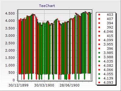

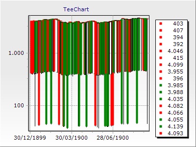

I have tested your project and here I have obtained results below:
Image1: Not Log Left Axis Image2: Log Left Axis I think that behaviour of Chart is correct using last version of TeeChart.Net 2010. If you are using TeeChart.Net 2010 and you don't believe results are correct, please explain us why, so we can help you. On the other hand, if you don't use last version TeeChart.Net 2010 please, tell us which version of TeeChart you are using now.

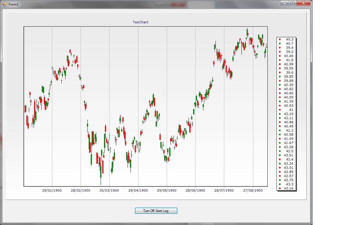

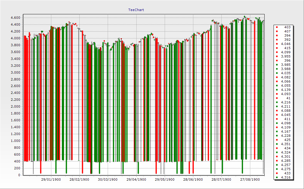

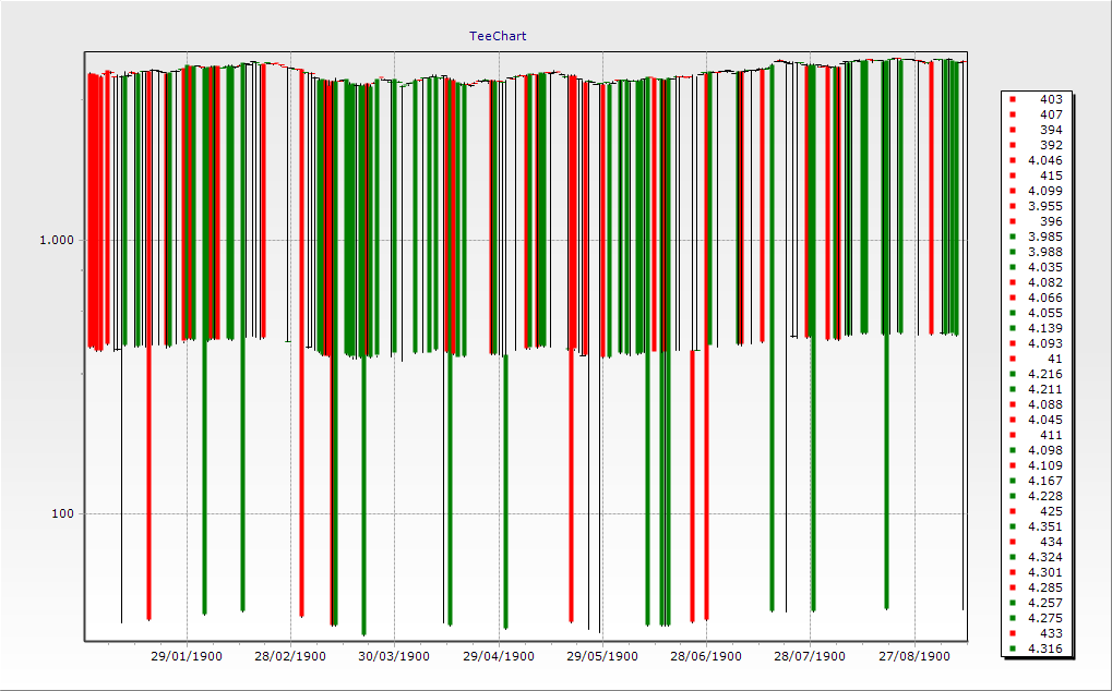

Your screen shots are different to what my chart displays, especially the scaling on the non log screen shot. I have posted screen shots of what my chart looks like in non log and log. The version of TeeChart used for the sample applicaiton is 4.1.2010.11301.
- Log
- Log.jpg (146.26 KiB) Viewed 9284 times
- Non Log
- No Log.jpg (146.26 KiB) Viewed 9285 times

Thanks for the files. I'm still getting the same as Sandra using it. I just added the reference to TeeChart.dll build 4.1.2010.11303, which is the latest release for VS2010. Then I changed project's target framework to 4.0 as build 4.1.2010.11303 is for that framework, compiled the application and got the screen-shots below. Actually I also added some code to export the images. Find also attached the project with the changes I told you. Following those steps do you get the same as we do? Please notice that Visual Studio may not be using the TeeChart assembly you think, I recommend you to remove TeeChart's AssemblyFolders entry as I described here before starting VS2010.
