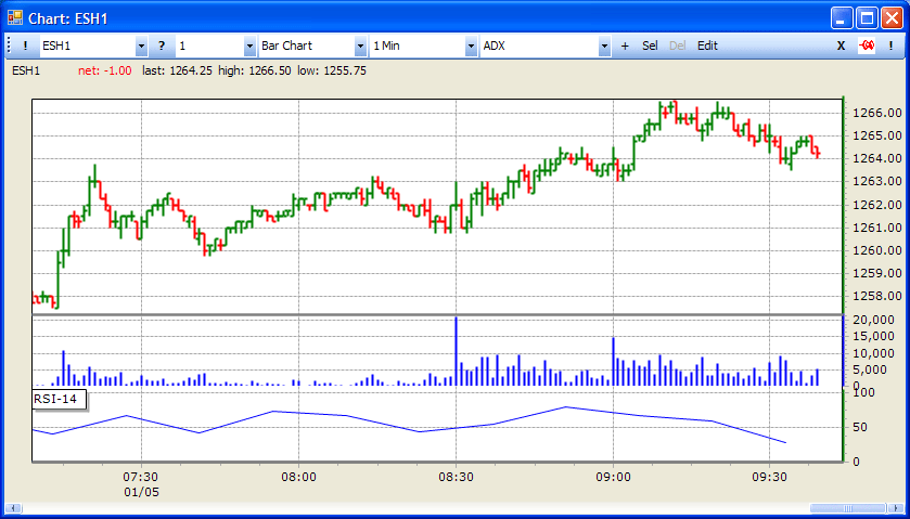

I am in the process of implementing some of your built in financial funcitons. Today I started with Stochastics and Relative Strength. I found that both of them seem to calculate one value every "Period" number of bars. I have tried setting PeriodStyle to both Range and NumPoints. Neither will do what I am expecting.
Let's look at the RSI study and assume we want to do a 14 bar analysis. On a standard RSI chart in TradeStation, ESignal, etc. a 14-bar RSI will have a data point for every bar beginning at the 14th bar (since you need 14 data points to make your first calculation). On TeeCharts, I get one point every 14 days. Here is a picture of what I get:
If you export the data to a spreadsheet and view it, you see 42 RSI data points out of 582 bars. That spreadsheet is attached.
Is there some way to set the RSI (or Stochastic or others like this) function so it looks at every "N" number of bars when doing the calculation (N = 14 in this case) while showing an RSI point for every day?

All Features\Welcome !\Functions\Financial\RSI has the same problem with it. It only calculates the RSI once every "N" number of bars, where "N" is the period specified in the study.
My question really has nothing to do with the horizontal scale. It has to do with the underlying method used to calculate the financial study (which affects both RSI and Stochastics). If you caluculate a 14 day moving average, it will calculate and display an average on the 14th bar. It will then calculate the average on the 15th bar, 16th bar, and every bar up to the end of the chart. That is a "Moving Average". With RSI and Stochastics if you do a 14 bar study, it calculates on the 14th bar as expected. The next calculation is not displayed until the 28th bar. Subsequent calculations appear on the 14-bar boundries. RSI, Stochastics, and any other financial functions, are commonly displayed with new calculations done on every bar, just like the moving avearage calculation. (If this is something that is supposed to be controlled by setting Line.Style = NumberOfPoints or Range, that is not working).
The second question has to do with the way the results of the data are stored in the YValues array. If I have a candle chart on the screen, I can find the X value for any given bar and use that to look up the Open, High, Low, or Close for that bar. If I have a moving average on that chart, if I look at the YValue(X) for any given day, I will not find the right moving average value. I have to do something like YValue(X - Period) to get it. As long as that is consistant, I am OK with it. Finding the RSI value for any given bar "X" is next to impossible. All the data for the RSI results is stored at the very beginning of the YValues array. I would think that the value of any study shown would be stored in the same "X" slot in the array as it appears on the chart.
Here is a chunk of data exported from a chart of the March 2011 ES contract today. The right-most column are the results of the RSI calculation. Notice how they all appear at the very beginning of the data. In reality, they were calculated once every 14 bars. In a perfect world, there would be no RSI results for the first 13 bars and then there would be results appearing for every bar after that.
(This data does not format properly when displayed on the web site forum. The actual spreadsheet is attached.)

This study was created using the following code:
Dim line1 As New Steema.TeeChart.Styles.Line(TChart1.Chart)
Dim RSI1 As New Steema.TeeChart.Functions.RSIFunction
RSI1.Style = Functions.RSIStyle.Close
line1.DataSource = CandleSeries1
line1.YValues.DataMember = "Close"
Dim Period As Double = 14
line1.Function.Period = Period
line1.Function.PeriodAlign = Functions.PeriodAligns.Last
line1.Function.PeriodStyle = Functions.PeriodStyles.NumPoints

Private Sub Form1_Load(ByVal sender As System.Object, ByVal e As System.EventArgs) Handles MyBase.Load
TChart1.Dock = DockStyle.Fill
TChart1.Aspect.View3D = False
Dim CandleSeries1 As New Steema.TeeChart.Styles.Candle(TChart1.Chart)
CandleSeries1.FillSampleValues(582)
RSI1.Style = Steema.TeeChart.Functions.RSIStyle.Close
'line1.Function = RSI1
'line1.DataSource = CandleSeries1
'line1.YValues.DataMember = "Close"
'line1.Function.Period = Period
'line1.Function.PeriodAlign = Steema.TeeChart.Functions.PeriodAligns.Last
'line1.Function.PeriodStyle = Steema.TeeChart.Functions.PeriodStyles.NumPoints
For index = Period To CandleSeries1.Count - 1 Step Period
line1.Add(CandleSeries1.XValues(index), RSI1.Calculate(CandleSeries1, index - Period, index))
Next
End Sub
Using code snippet below produces the Excel file which I attach. As you can see X values for RSI function series are included. Their columns are displayed according to the point indexes in the series but X values are correct.The code snippet below will display RSI value for the 100th point in the Candle series.dave wrote:The second question has to do with the way the results of the data are stored in the YValues array. If I have a candle chart on the screen, I can find the X value for any given bar and use that to look up the Open, High, Low, or Close for that bar. If I have a moving average on that chart, if I look at the YValue(X) for any given day, I will not find the right moving average value. I have to do something like YValue(X - Period) to get it. As long as that is consistant, I am OK with it. Finding the RSI value for any given bar "X" is next to impossible. All the data for the RSI results is stored at the very beginning of the YValues array. I would think that the value of any study shown would be stored in the same "X" slot in the array as it appears on the chart.
TChart1.Export.Data.Excel.IncludeIndex = True
TChart1.Export.Data.Excel.IncludeSeriesTitle = True
TChart1.Export.Data.Excel.Save("C:\\temp\\ChartData\\RSIData.xls")
Dim index As Integer = line1.XValues.IndexOf(CandleSeries1.XValues(100))
If index <> -1 Then
TChart1.Header.Text = line1.YValues(index).ToString()
End If
End Sub

It has been a while since I originally left this message. I hope I recall the situation properly here. I am not sure about your terminology, but I am guessing that the answer is No. I am not looking for a moving average of the results of the RSI calculation. (That is to say, I am not looking to average the results over time in any way.)
TChart seems to have two concepts relating to time, Intervals and Ranges. If you do a 20 day Average, it will calculate a single number every 20 days. A Moving Average is the calculation of the average of the preceding 20 points, which is calculated on every bar.
Typical financial charts will calculate a new value on every bar, just like a moving average is calculated. A study that calculates one value only every 20 bars would be pretty much useless.
The Welles Wilder "Relative Strength" study compares the Average Gain / Average Loss for some "N" bar interval. If "N" is 20, the first calculation would be made on the 20th bar of the chart. At that bar, you would calculate the Average Gain for bars 1 to 20 and the Average Loss during that same time. After normalizing to 100, you have one point. When there is a new bar available, you make the same calculation, but you use bars 2 through 21. The next bar uses data from bars 3 to 22, etc. The result is that on any given bar there is an associated RSI value. (I think the current RSI study is calculating on bars 1 to 20, then on bars 21 to 40, then on 41 to 60, etc. Likewise with the Stochastics, instead of calculating a new Stochastic value on each bar, its being calculated on every 20th bar.)
Your question here asks about a Moving Average RSI. That is actually a valid study which takes the raw RSI values and then creates a moving average of them. That, however, is not what I am after here. I guess it all comes down to the way these studies are "normally" displayed. With each of these financial studies, for each bar you calculate a new value for the study. (Off hand, I can not think of any financial studies that are calculated only every "N" number of bars. Each that I know of is calculated AT each bar, FOR the preceding "N" number of bars.)

Re: Unusual Financial Function Calculations
Hi dave,
You could also create your custom function deriving from existing ones and overriding necessary methods, for example:
I recommend you to use Red Gate's .NET Reflector or Telerik's JustDecompile to disassemble TeeChart.dll and see how TeeChart functions are implemented so you can use them as a guide for your own function.
public class MyRSI : Steema.TeeChart.Functions.RSIFunction
public MyRSI()
public override double Calculate(Steema.TeeChart.Styles.Series source, int first, int last)
return base.Calculate(source, first, last);
protected override void CalculateAllPoints(Steema.TeeChart.Styles.Series source, Steema.TeeChart.Styles.ValueList notMandatorySource)
base.CalculateAllPoints(source, notMandatorySource);
protected override void DoCalculation(Steema.TeeChart.Styles.Series source, Steema.TeeChart.Styles.ValueList notMandatorySource)
base.DoCalculation(source, notMandatorySource);
