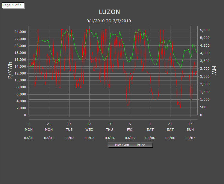

I would like to know which property to set to maximize the size of the chart? The chart has a lot of bottom spaces. Please see attached sample.

If you don’t want a lot of bottom spaces in your WebChart I recommend that change margin values as do in next line of code:
 tChart1.Panel.MarginBottom = 0;
Can you please, tell us if it is a solution for you? If it doesn't solve your problem, please send us a simple example so we can reproduce your problem here.
