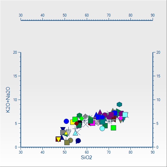

I need to adjust the aspect ratio of the points chart. If I set the Left and right axis start position to 25%
Points1.Chart.Axes.Left.StartPosition = 25
Points1.Chart.Axes.Right.StartEndPositionUnits = Steema.TeeChart.PositionUnits.Percent
Points1.Chart.Axes.Right.StartPosition = 25
The Left and Right Axis plot correctly, but if I add the top axis, it does not plot in the correct position
Points1.Chart.Axes.Right.Visible = True
Points1.Chart.Axes.Bottom.Visible = True
Points1.Chart.Axes.Left.Visible = True
Points1.Chart.Axes.Top.Visible = True
See picture

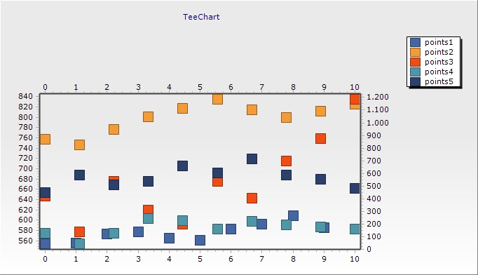

This works OK, but a new problem is introduced. The labels on the top axis are not positioned correctly. See picture.

I couldn't reproduce your problem using last version of TeeChart.Net. I have got next image where axes labels see correctly:
