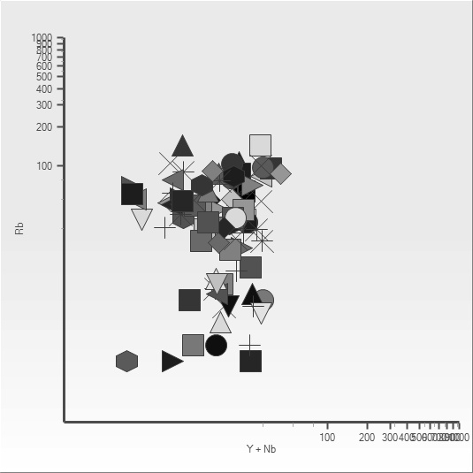

I need log plots for my app.
I am having trouble displaying the following lagarithmic scale:
MinYTLog = 1
MaxYTLog = 1000
MinXTLog = 1
MaxXTLog = 1000
Points1.Chart.Axes.Bottom.Logarithmic = True
Points1.Chart.Axes.Right.Logarithmic = True
Points1.Chart.Axes.Left.Logarithmic = True
Points1.Chart.Axes.Bottom.Labels.OnAxis = True
Points1.Chart.Axes.Left.Labels.OnAxis = True
Points1.Chart.Axes.Right.Labels.OnAxis = True
Points1.Chart.Axes.Bottom.Labels.Style = Steema.TeeChart.AxisLabelStyle.Auto'
Points1.Chart.Axes.Left.Labels.Style = Steema.TeeChart.AxisLabelStyle.Auto
Points1.Chart.Axes.Right.Labels.Style = Steema.TeeChart.AxisLabelStyle.Auto
Points1.Chart.Axes.Right.AutomaticMaximum = False
Points1.Chart.Axes.Bottom.AutomaticMaximum = False
Points1.Chart.Axes.Left.AutomaticMaximum = False
Points1.Chart.Axes.Right.AutomaticMinimum = False
Points1.Chart.Axes.Bottom.AutomaticMinimum = False
Points1.Chart.Axes.Left.AutomaticMinimum = False
Points1.Chart.Axes.Bottom.Maximum = MaxXTLog2
Points1.Chart.Axes.Bottom.Minimum = MinXTLog2
Points1.Chart.Axes.Bottom.MaximumOffset = 0
Points1.Chart.Axes.Bottom.MinimumOffset = 0
Points1.Chart.Axes.Left.Maximum = MaxYTLog2
Points1.Chart.Axes.Left.Minimum = MinYTLog2
Points1.Chart.Axes.Right.Maximum = MaxYTLog2
Points1.Chart.Axes.Right.Minimum = MinYTLog2
Points1.Chart.Axes.Left.MaximumOffset = 0
Points1.Chart.Axes.Left.MinimumOffset = 0
Points1.Chart.Axes.Right.MaximumOffset = 0
Points1.Chart.Axes.Right.MinimumOffset = 0
Points1.Chart.Axes.Bottom.Labels.ValueFormat = "0.#"
Points1.Chart.Axes.Left.Labels.ValueFormat = "0.#"
Points1.Chart.Axes.Right.Labels.ValueFormat = "0.#"
Points1.Clear()
Points1.XValues.Order = Steema.TeeChart.Styles.ValueListOrder.None
Points1.YValues.Order = Steema.TeeChart.Styles.ValueListOrder.None
Dim i As Long
For i = 1 To NumberofSamples
Points1.Add(XVal(i - 1), YVal(i - 1), "", Color(i - 1))
Next i
See picture

Post by lilo » Thu Nov 11, 2010 9:07 am
If I plot a points chart with log scale in a new project, it works fine.
I cannot get it to work in my existing project.
If I use
Points1.Chart.Axes.Bottom.AutomaticMaximum = True
Points1.Chart.Axes.Left.AutomaticMaximum = True
Points1.Chart.Axes.Bottom.AutomaticMinimum = True
Points1.Chart.Axes.Left.AutomaticMinimum = True
it works fine.
If i use
it won't plot all the labels?

Post by lilo » Thu Nov 11, 2010 2:44 pm
The real cause of the problem is not having this property set:
Points1.Chart.Axes.Bottom.Increment = 0
Points1.Chart.Axes.Left.Increment = 0
Points1.Chart.Axes.Right.Increment = 0
Points1.Chart.Axes.Top.Increment = 0
