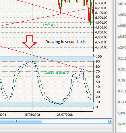

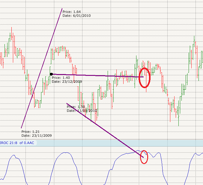

I have a chart with multiple axes and in the top axis I have stock data and many trend lines drawn ... when I zoom in to my stock data the trend lines (drawlines) render on the custom axis. see image.
Is there a way to set up a clipping region (or whatever clipping mechanism) to stop drawlines in the top axis from 'overflowing' onto my custom axis.

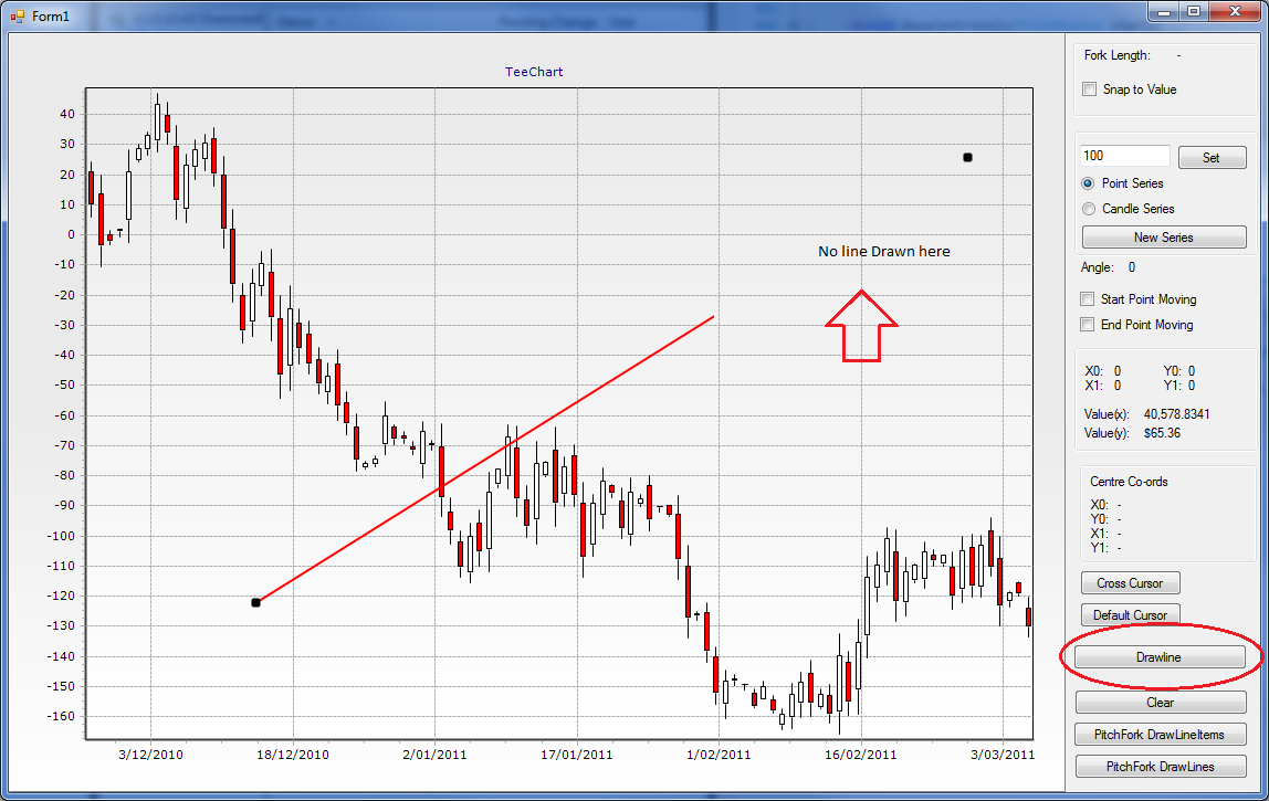

Here is the first problem I came up against
you can replicate by hitting the drawline button and dragging across the screen ... it will clip for no apparent reason.
remove the line "Drawline.Series = candles" and there is no clipping at all.

I couldn't reproduce your problem using last maintenance release of 28 of September. Please, download last version of TeeChart.Net and try again if your problem appears. If your problem after upgrade still appears, please send us a simple project, because we can reproduce your problem here.
