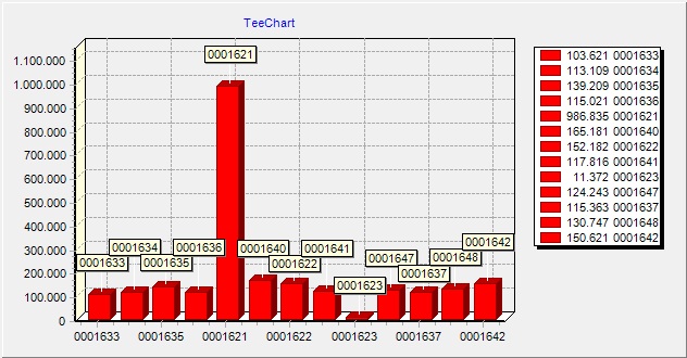

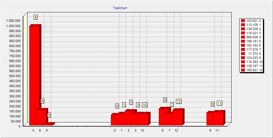

Using code above with latest TeeChart for .NET v2 release available at the client download area I got this chart:
As can be seen in bars marks, they are not sorted. Do you get the same at your end? Are you using latest v2 release available?

Yes, I understand now what you mean but what I get I think it's correct as you are populating series using those values as X values, they are not sorted but plotted at the X position corresponding to the X value you provided. To get what you request you shouldn't use those values as X values, just use them as points labels and let series automatically use sequential X values replacing points.Add() call in previous example for this:
        points.Add(dslagmass, response[i][0].ToString());
Which produces the chart below. Is that what you were looking for?
BTW: If that's what you need then it's not necessary to set XValues.Order to none either.
