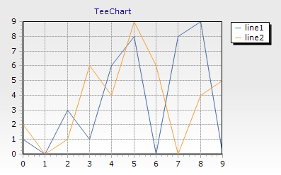

Post by ctusch » Tue Dec 21, 2010 1:23 pm
It doesn't work here, it looks like this:
I'm using version 3.5.3700.30575.
Re: Axis.Automatic with a margin
Post by Sandra » Tue Dec 21, 2010 2:55 pm
Hello ctusch,
Your problem is solved in last version of TeeChart.Net (version 4) and in it version works correctly. For version 3 there are a workaround using StartPosition and EndPosition:
