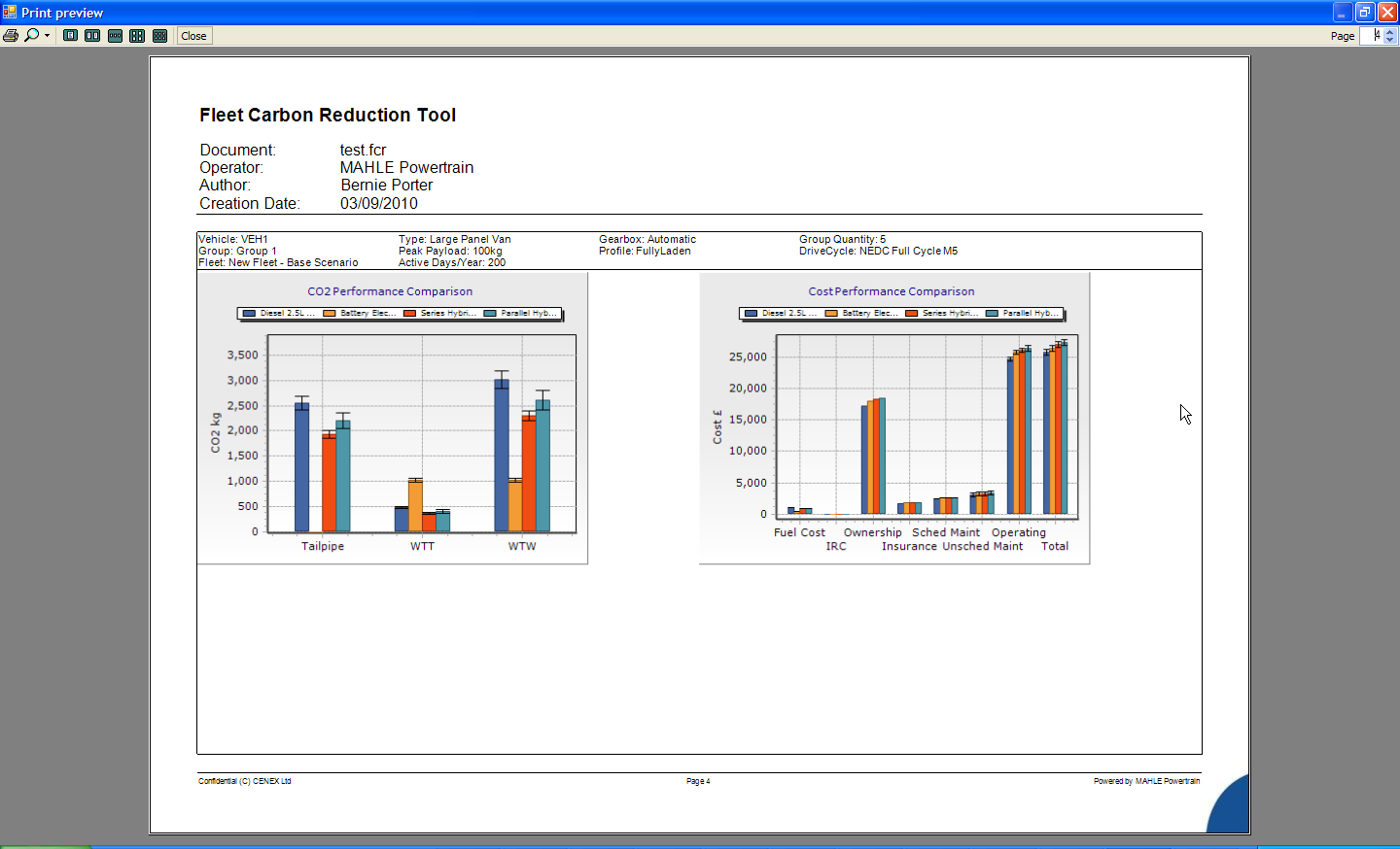

I have a requirement to output to a print document, which is working to a point with the following code:
            Stream CO2PlotStream = new MemoryStream();
            tcCO2Plot.Export.Image.PNG.Save(CO2PlotStream);
            Image CO2PlotImage = Image.FromStream(CO2PlotStream);
This is then drawn on the print engine in the OnPrint event where Bounds is the calculated page bounds.
            e.Graphics.DrawImage(Image, Bounds);
However, the image appears fuzzy - see the attached screenshot of the resultant document in PDF form.
Extract from Print call
PDF Report ScreenCap.png (87.78 KiB) Viewed 4486 times

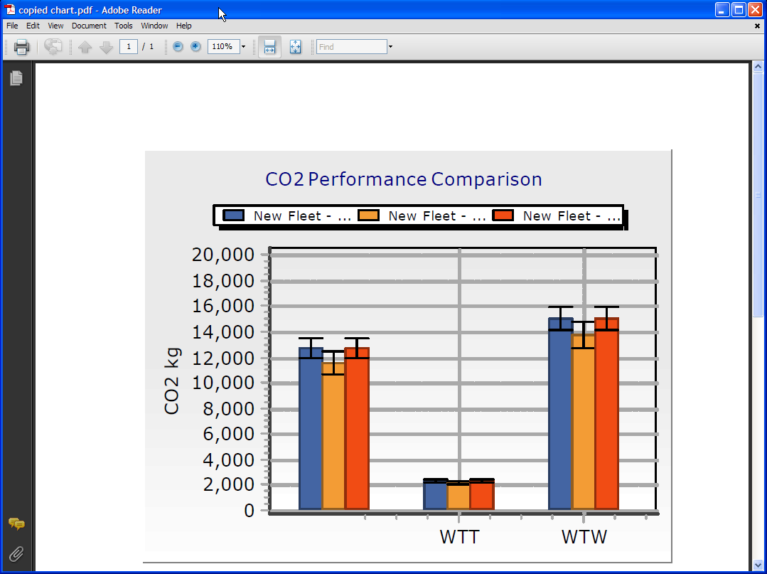

Contrast with a clipboard copy to Word and PDF - The clipboard copy is generated with the following code
            Chart.Export.Image.Metafile.CopyToClipboard();
And produces the following when PDFd (and screen cap'd)...
PDF Clipboard ScreenCap.png (55.87 KiB) Viewed 4461 times

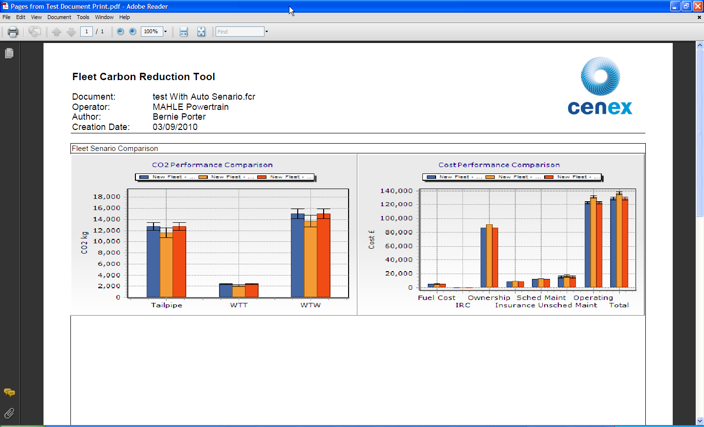

The clipboard copy is working fine - the issue is with the printed output. Now, I'm a bit of a newbie at printing in C#, but it seems to me that I need an Image object to pass to the Graphics.DrawImage method in the PrintDocument OnPrint event handler. I'm generating this image using the tcChart.Export.Image method into a memory stream, then creating an image object from that. Now, Graphics.DrawImage is scaling the image to fit the specified bounds, but that is not the root cause of the problem - using Graphics.DrawImageUnscaled generates this.
PDF Report ScreenCap Unscaled.png (93.15 KiB) Viewed 4437 times
As you can see, this is still blury although the font proportions are now better. I think I need to be able to control the size of the image I generate - is this possible? Or do you have a better way of getting something I can use with a Graphics object?
