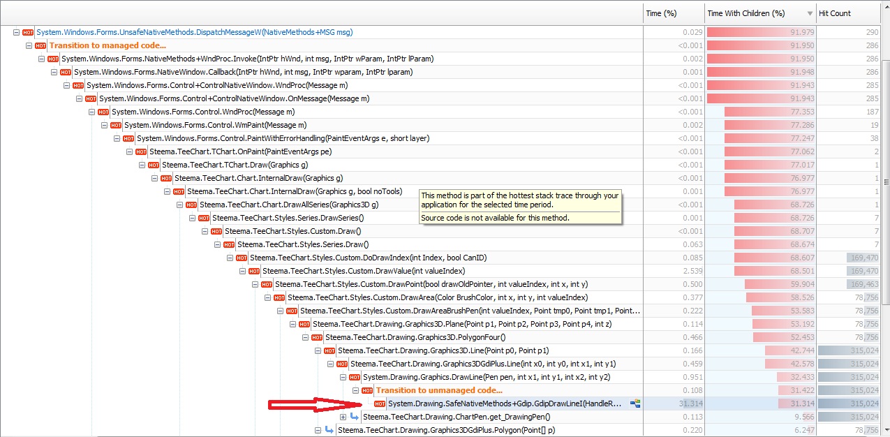

I have a graph with two options (line chart and area chart). The line chart is pretty fast even with lot of data.
But the area chart is very slow. I did some investigation with ants profiler to see which process is taking so much time.
I have attached a screenshot of the profiler results.
Is there any solution to this problem? It seems to occur in the teechart dll.

Hello SPS,
Your arrow is pointing to System.Drawing.SafeNativeMethods+Gdip.GdipDrawLineI method and it is not a Steema method. This method is a .NET Framework method, and I fear, we can not do much for solve it. On the other hand, I recommend you try to using a HatchBrush (a brush with lines rather than a solid brush) and check if now, your application works faster than before.

Well it's still very slow with a hatchbrush.
When i run this simple sample project it takes like 15-20 sec to draw the graph:
Any other ideas would be appreciated.
Steema.TeeChart.Styles.Area area1 = new Steema.TeeChart.Styles.Area(this.teeChartControl.Chart);
area1.Brush.Solid = false; //DrawingBrush now returns: {System.Drawing.Drawing2D.HatchBrush}
teeChartControl.Series[0].FillSampleValues(100000);
