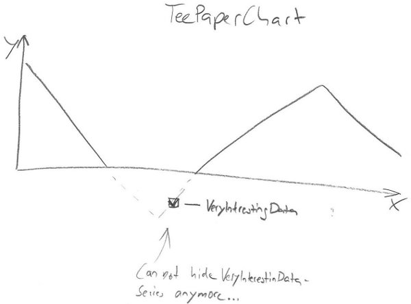

Toggling the visibility of certain series by using the corresponding checkboxes of the legend seems to fail under some special circumstances.
Imagine a series gets (invisibly) painted even beyond the chart axes. If such a line crosses the location of a checkbox, this checkbox is no longer clickable. Please take a look at the beautiful "TeePaperChart" attached to this post for further clarification.
Unfortunately we stick at version 2.0.2987.19069 as our reporting component has some issues with nested controls and just does not display the charts when using newer TeeCharts versions.
May I ask you for your assistance to find a workarround to get those checkboxes working under all circumstances? We would higly apprechiate your help.
Thank you very much
Manuel
