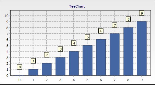

The following code
TChart tChart = new TChart();
tChart.Series.Add(new Bar());
Bar series = tChart[0] as Bar;
tChart.Aspect.View3D = false;
for (int i = 0; i < 10; i++)
    series.Add(i);
series.ShowInLegend = false;
produce the TChart, represented at the picture:

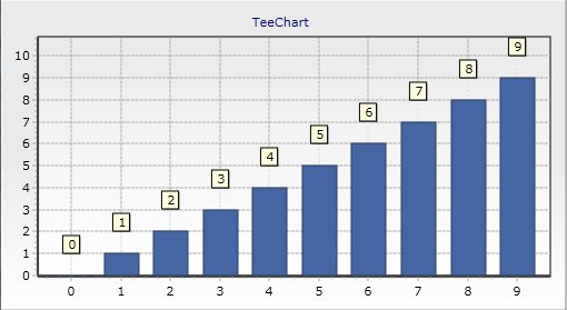

But after the exporting to xaml I receive the incorrect result:
The dashed grid lines is very thick in comparison with the original.
