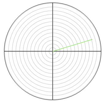

I have a polar bar series as shown in the attached image. How can i make sure the concentric circles are NOT drawn. I tried every thing, but could not turnoff these concentric circles. Please help.

Here is my code
For Chart:
With MyChart
                .Legend.Visible = False
                .Panel.Color = Color.White
                .Panel.Gradient.Visible = False
                .Text = "Phasor Display"
                .Axes.Left.TicksInner.Visible = False
                .Axes.Right.TicksInner.Visible = False
                .Axes.Top.TicksInner.Visible = False
                .Axes.Bottom.TicksInner.Visible = False
                .Axes.Left.AutomaticMaximum = False
                .Axes.Left.Labels.Visible = False
                .Axes.Bottom.AutomaticMaximum = False
                .Axes.Bottom.Labels.Visible = False
                .Axes.Right.AutomaticMaximum = False
                .Axes.Right.Labels.Visible = False
                .Axes.Top.AutomaticMaximum = False
                .Axes.Top.Labels.Visible = False
                .Axes.Left.AutomaticMinimum = True
                .Axes.Bottom.AutomaticMinimum = True
                .Axes.Right.AutomaticMinimum = True
                .Axes.Top.AutomaticMinimum = True
                .Axes.Top.Grid.Visible = False
                .Axes.Bottom.Grid.Visible = False
                .Axes.Right.Grid.Visible = False
                .Aspect.Elevation = 315
                .Aspect.Rotation = 360
                .Aspect.SmoothingMode = System.Drawing.Drawing2D.SmoothingMode.HighQuality
                .Aspect.TextRenderingHint = System.Drawing.Text.TextRenderingHint.ClearTypeGridFit
                .Aspect.View3D = False
                .Axes.Bottom.Labels.Font.Shadow.Visible = False
                .Axes.Bottom.Labels.Shadow.Visible = False
                .Axes.Bottom.Title.Font.Shadow.Visible = False
                .Axes.Bottom.Title.Shadow.Visible = False
                .Axes.Bottom.TickOnLabelsOnly = True
                .Axes.Bottom.MinimumOffset = 5 ' 5 pixels
                .Axes.Depth.Labels.Font.Shadow.Visible = False
                .Axes.Depth.Labels.Shadow.Visible = False
                .Axes.Depth.Title.Font.Shadow.Visible = False
                .Axes.Depth.MinimumOffset = 5
                .Dock = DockStyle.Fill
                .Footer.Visible = True
            End With
For Polarbar
phasorBar = New Steema.TeeChart.Styles.PolarBar
                phasorBar.Pointer.Style = Steema.TeeChart.Styles.PointerStyles.Cross
                phasorBar.Color = Color.Red
                phasorBar.Pen.Width = 2
                phasorBar.Pointer.Pen.Color = Color.Transparent
                phasorBar.Pen.EndCap = Drawing2D.LineCap.ArrowAnchor
                phasorBar.Circled = True
                phasorBar.Marks.Visible = False
                MyChart.Series.Add(phasorBar)

Hi asupriya,
I think you need to hide the Left Axis Grid:
tChart1.Axes.Left.Grid.Visible = false;

Post by asupriya » Tue Aug 31, 2010 11:22 am
Thank you Yeray. It took care of the issue.
