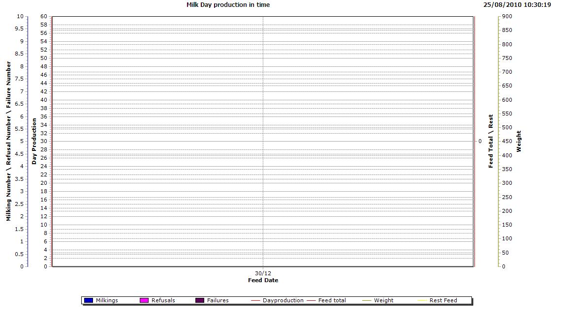

I want to make gridline in my graph just for x axis. I use for this "tChart1.Axes.Left.Grid.Visible=false;" and so in my all graph,gridline is shown just x axis.But just for one pragh gridline is shown both,x and y axis.I put belove inccorect graph.what is different in belove graph and how can i show gridline in just x axis for this graph?

Hi Solutions Gallery BV,
You could run the following code to hide all them:
    Chart1[i].GetVertAxis.Grid.Visible:=false;
If you still have problem with it, please try to arrange a simple example project we can run as-is to reproduce the problem here.
