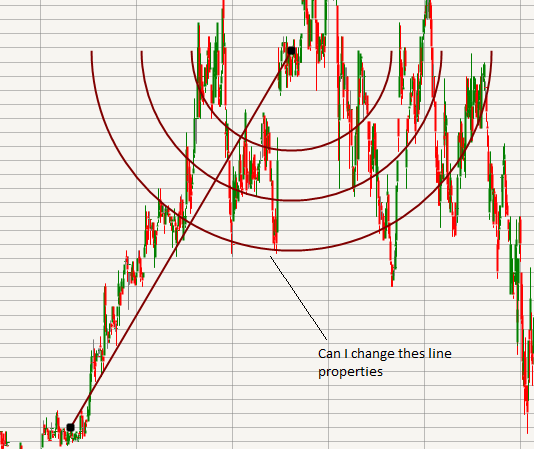

Question 1: So how do I add another tool to Teechart?(which will be a clone of DrawLine.cs)
Now because there is no documentation for the source code I'm doing the hack thing and guessing at how the Charts work 'under the hood' ... please feel free to scream in dismay at my hacking ;-)
Question 2:
Drag Handles - I dont understand how these work and I'm stuffing something up. see the below image.
Item 1 is a standard Drawline .. when the mouse hovers over the centre of the line the mouse icon changes to a hand indicating the line can be Dragged.
In the case of item 2 the arrow points to where the drag handle is (somewhere out in space) .. can you explain to me how to set the area for these Drag handles ??? i.e. put the drag handle in the correct place.
(please note Screen capture doesnt capture the mouse ... so 'pretend' you can see a hand icon where the arrow points ;-) )
Question 3: Can I adjust the line properties of these independantly .. at the moment everything inherits from the same values .. do you think I should be approaching this differently ? Drawline does have a collection of lines I noticed but I'm not sure how to deal with them.(please refer to above Code (AStyle == DrawLineStyle.FibonacciArc) where you can see the code I ripped off the Fibonacci class)
Line Properties.png (43.36 KiB) Viewed 3189 times
Edit: Upon reflection I think the way to deal with the 2 above problems is to overload the line styles, kind of how they are now, but ensure they only draw 1 line (as originally designed) and in the case of the fibonacci I can create a Drawline that has 4 DrawLineItems - 1 drawline and 3 Fibonacci Lines .. then I'll still be able to drag the straight drawline AND have some control over the styles of each fibonacci Arc ....
Edit 2: Well that great idea didnt work at all ... all the drawlineItems have a single x,y points .. they obviously need to have there start and end points set before they get to the drawing routines .. wheras I want to draw them based on the position of the first drawn line .. back to the drawing board on that idea.
I think the best option would be searching for all DrawLine and related classes references in the TeeChart source code project and do the same with your DrawLine2.cs. Don't forget to add it to the sources project too. Alternatively you could create tools inheriting from existing ones.
Question 2:
IIRC DrawLine tool handles automatically move accordingly with dragged lines, there's not need to move them manually, aren't they? If that's not what you meant could you please give us more details about what you are trying to do?
Yes, you can access each line in a DrawLine tool manually and modify it. I see you already found that in your message edits :wink:. You'll find an example at All Features\Welcome !\Tools\Draw Lines\DrawLine Tool in the features demo included with TeeChart's binary installers.
You may also manually add new lines to a DrawLine tool.
