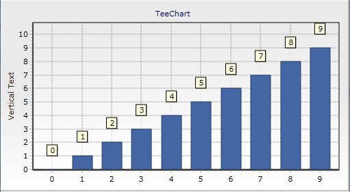

I have problem with export TeeChart with vertical title to xaml format.
For example, if I try to export following instance of TeeChart to xaml

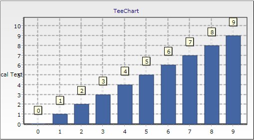

In result I receive xaml, represented at the picture:
The vertical text became horizontal.

You are right. It seems that exporting to XAML, the angles in Labels, Marks or Axis Titles are lost. I've added it to the defect list (TF02015086).
