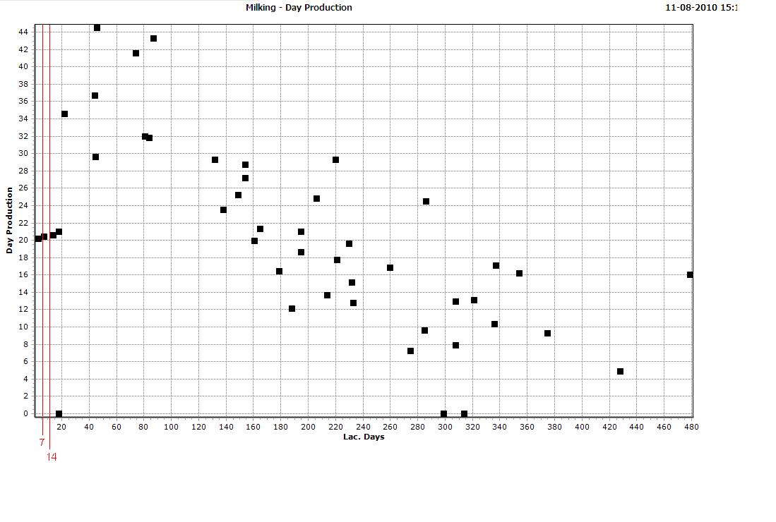

i want to make in my graph X axis gridline as shown in picture with RedLine.Normally X axis gridline goes by 20 to 20.But i want it as goes 7 to 7 as showen in picture.

I seem that you can use property of axes Increment and property of labels axes alternate, because grids go 7 to 7 as next lines of code:
            tChart1.Axes.Bottom.Increment = 7;
            tChart1.Axes.Bottom.Labels.Alternate = true;
Could you please, tell us it solution works as you want?

Thanks for your responding.I think the code which you wrote is ok.It is as i wanted.
