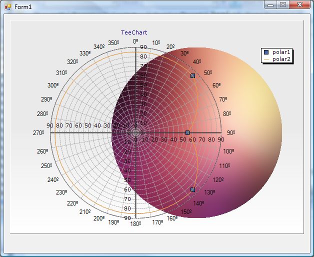

2. When the Form is resized very quickly, the image is drawn with an offset. See the screenshot:
TChart Polar Background Image.jpg (64.33 KiB) Viewed 7424 times
Do you have any ideas?
Thanks in advance,
SurveyBob

SurveyBob wrote:2. When the Form is resized very quickly, the image is drawn with an offset. See the screenshot:
Forcing a chart repaint solves it but, of course, it will be a little bit slower.
        tChart1.Resize += new EventHandler(tChart1_Resize); // in InitializeChart
        void tChart1_Resize(object sender, EventArgs e)
            tChart1.Draw();

Thanks, Yeray, that worked.
The redrawing really slows down resizing of the control pretty much, but for now, that's ok. At least it's drawn correct.
