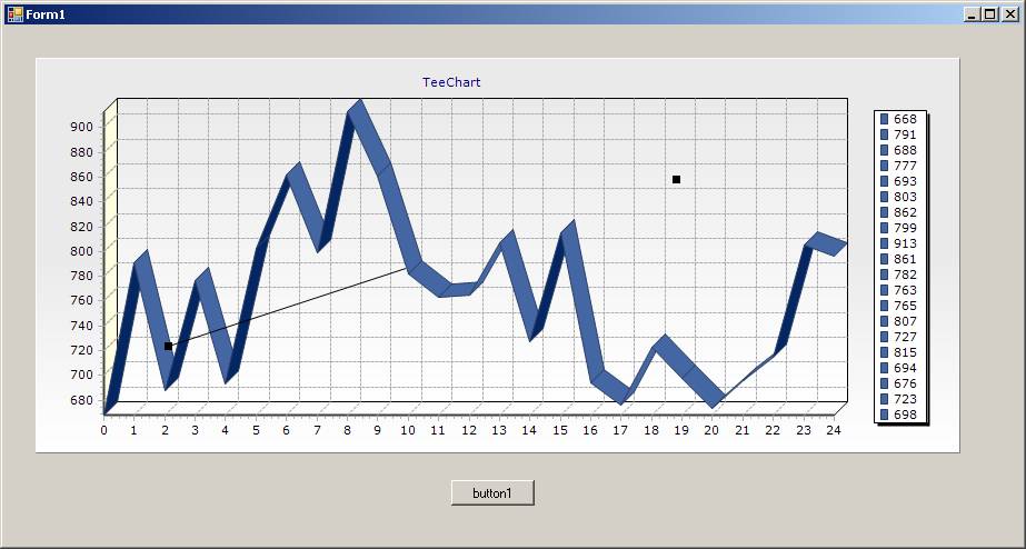

Please help us to fix problem with drawing trend line: it is not drawing in right part of the chart.
We use v4.0.2009.42281 (in v2010 we see the same problem).
We need instructions how to fix it in the sources.
Here is a code (draw line after pushing button):
            Line line = new Line();
            line.FillSampleValues();
            tChart1.Series.Add(line);
            DrawLine tool = new DrawLine();
            tChart1.Tools.Add(tool);
            tool.Series = line;
            tool.EnableDraw = true;
            tool.EnableSelect = true;
and example screenshort in the attach.
Thank you.

Sorry for delay. I couldn't reproduce your problem using your code and last maintenance release of TeeChart.Net 2010. Could you please, update your version of TeeChart . Net and checked if your project works correctly?
