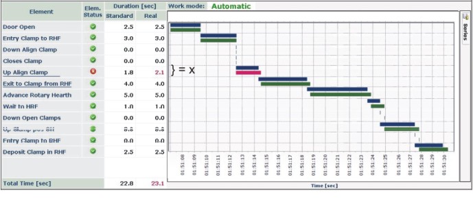

Re: fix increment
This is the image
The idea is that each pair of gantt graph bars staying in the same line of their corresponding row of the tabular data for any number of elements.
In this example I have 12 elements, and x have one value.
I need that x has the same value If there are 5 or 15 elements,

Re: fix increment
Hi tenaris,
Thanks for the picture and the explanation but I'm afraid I'm still not sure to understand what are you exactly trying to achieve.
If you want the right axis to always have the same minimum and maximum regardless of the number of gantts you have, you can call SetMinMax function.

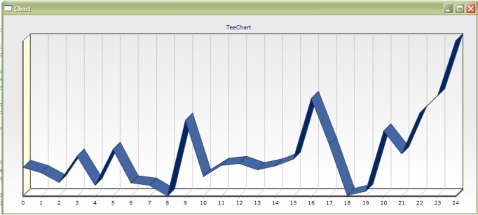

Re: fix increment
Thanks for reply
I had success in reduce the height of the bars in graphics gantt, but I couldn´t eliminate the labels in the left axe without eliminate the thicks and grid. I wrote the first code and grids and thicks were eliminated
I'm doing wrong?
I'm doing wrong?

Re: fix increment
Hello tenaris,
I couldn't reproduce your problem using previous code with last version of TeeChart.WPF and I have get next image, where grid and ticks of left axis, still appears. Could you please, say us what version of TeeChartWPF you are using currently?

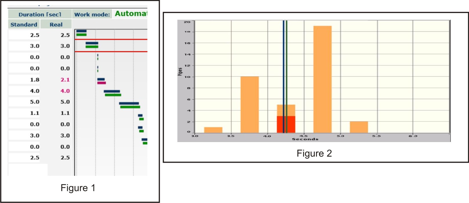

Re: fix increment
It worked out. I was doing wrong.
But settig labels with blank spaces doesn't solve my problem.
I need my panel not to have margin on the left side. And it's only possible if I remove the labels at the left axis (that includes the grid, and I don´t want to remove it). is It correct?
One alternative could be:
To draw lines that simulate the grid.
could it be possible?
I thought this because I need a tool tip in my gantt bar when the mouse is over it, and I do it this way:
When I do that, the labels in the left axis are very big, and the space between the axis and the begining of the panel is very big too. That's why I need to remove the labels,
and that is why I thought to draw lines like rows. (see figure 1 -the red lines-)
My questions are
1.-Is it possible to eliminate the space between the beginning of the panel and the left axis?
2.-Is it possible to draw lines like rows in figure 1 and lines like fixed values (see figure 2)?
3.-Is the way i´m using the tool tip correct?
