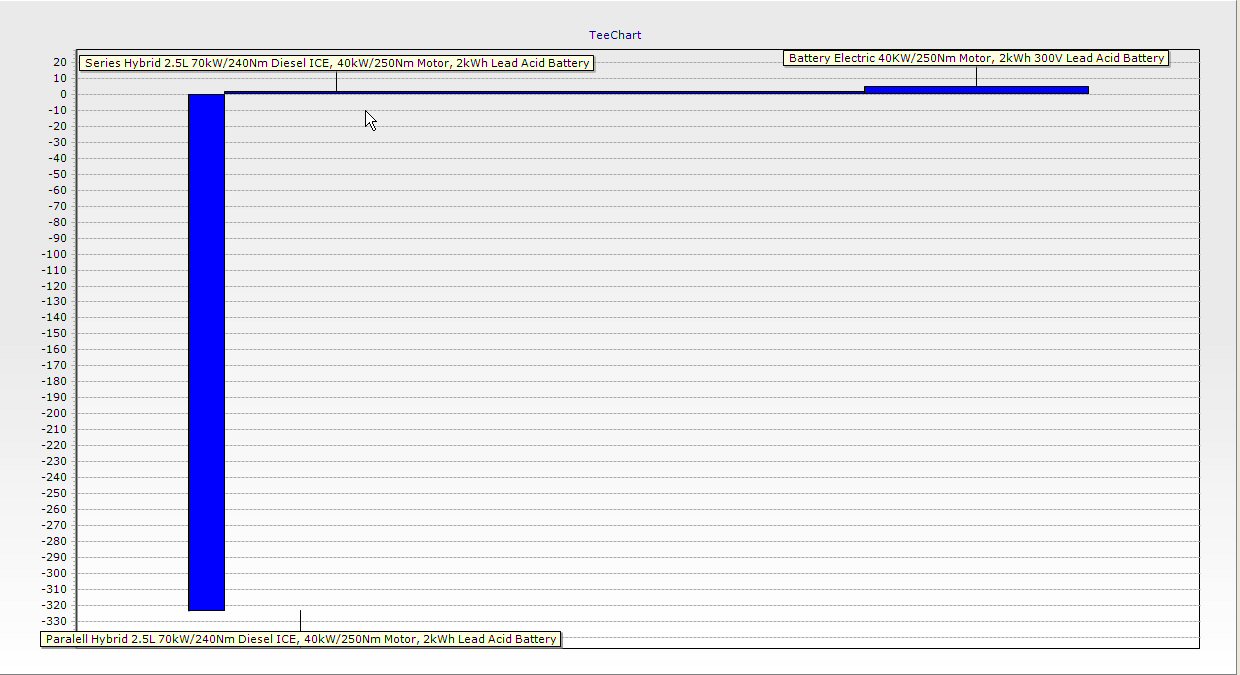

I've attached an image of what's being output - my question now is how can I get the callout labels to line up with the appropriate bar (the Paralell Hybrid is the long bar at the LHS), and can I make the callout wrap onto multiple lines wihout changing the source text?

Bernie wrote:I've attached an image of what's being output - my question now is how can I get the callout labels to line up with the appropriate bar (the Paralell Hybrid is the long bar at the LHS)
You could reposition your marks manually doing something like this:
        private void RecalcMarkPositions()
            tChart1.Draw();
            for (int i = 0; i < bar1.Marks.Positions.Count-1; i++)
                Steema.TeeChart.Styles.SeriesMarks.Position mp1 = bar1.Marks.Positions[i];
                mp1.Custom = true;
                int middle = bar1.CalcXPos(i) + ((tChart1.Axes.Bottom.CalcXPosValue(widths[i]) - tChart1.Axes.Bottom.CalcXPosValue(0)) / 2);
                mp1.LeftTop.X = middle - (int)(tChart1.Graphics3D.TextWidth(bar1.YValues[i].ToString())/ 2) - 4;
                mp1.ArrowFix = false;
                mp1.ArrowTo.X = middle;
                mp1.ArrowFrom.X = middle;
Bernie wrote:and can I make the callout wrap onto multiple lines wihout changing the source text?
You can use OnGetSeriesMark doing somethink similar to this:
        void bar1_GetSeriesMark(Steema.TeeChart.Styles.Series series, Steema.TeeChart.Styles.GetSeriesMarkEventArgs e)
                e.MarkText = e.MarkText.Substring(0, 10) + "\n" + e.MarkText.Substring(10, e.MarkText.Length-10);
