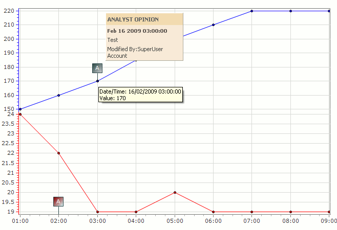

I've added annotations to my chart and I have it so that custom text is displayed in a pop up on the mouseover event. This was achieved in the standard way i.e. using GetHTMLMap and MapElements etc. (i.e. the pop up is handled by TeeCharts ShowAnnotations script). However, I've noticed that the position of the pop up varies depending on how far down you've scrolled on the page - sometimes the pop up isn't visible at all, i.e. its positioned towards the top of the page when you've scrolled down. (I think this is a known issue?). Is there a way to position the pop up in a fixed location, for example always at the upper left or upper right hand corner of the chart instead? This must be achieved without affecting the pop ups that appear over the series points which I also have on my chart and which appear to always show in the correct position.

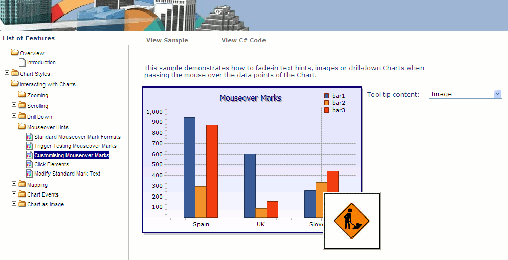

You might find that the WebChart demo "Interacting_with_Chart : .Mouseover_Hints : CustomisingMouseoverMarks" is similar to what you're looking to achieve. That example uses Steema.TeeChart.Tools.CustomHotspot to assign a mouseover text to the Legend. CustomHotspot is intended to offer access to any Chart location in the same way (can be relative to Chart top, left .. etc). CustomHotspot can work alongside SeriesHotspot as per the example, so shouldn't affect any other hotspots you have already setup. Locations set here should scroll correctly with the Chart on the page.

The example I see at the location you provided (i.e. Interacting_with_Chart : .Mouseover_Hints : CustomisingMouseoverMarks) demonstrates how to fade-in text hints, images or drill-down Charts when passing the mouse over the data points of the Chart. You can choose the type of Tool tip content you wish (either image, statistics chart, num. of accidents). I dont see any reference to a legend.

The Analyst Opinion popup appears when you hover over the A annotation except it isn't apparent on a page where you've scrolled vertically.

I may have misunderstood what you require, let's backtrack a little just in case. The demo in question, "Interacting_with_Chart : .Mouseover_Hints : CustomisingMouseoverMarks", that you've made a screenshot of, is the one I was referring to.
The demo does do what you say, ie. "fade-in text hints, images or drill-down Charts when passing the mouse over the data points of the Chart", but also displays a mouseover text dialogue when you pass the mouse across the Legend. The text is always displayed just below the Mousepointer but only when the mousepointer is over the Legend. That remains the case if I size the window to force a scrollbar on the demo and scroll it up or down. The type of hotspot is Steema.TeeChart.Tools.CustomHotspot.
