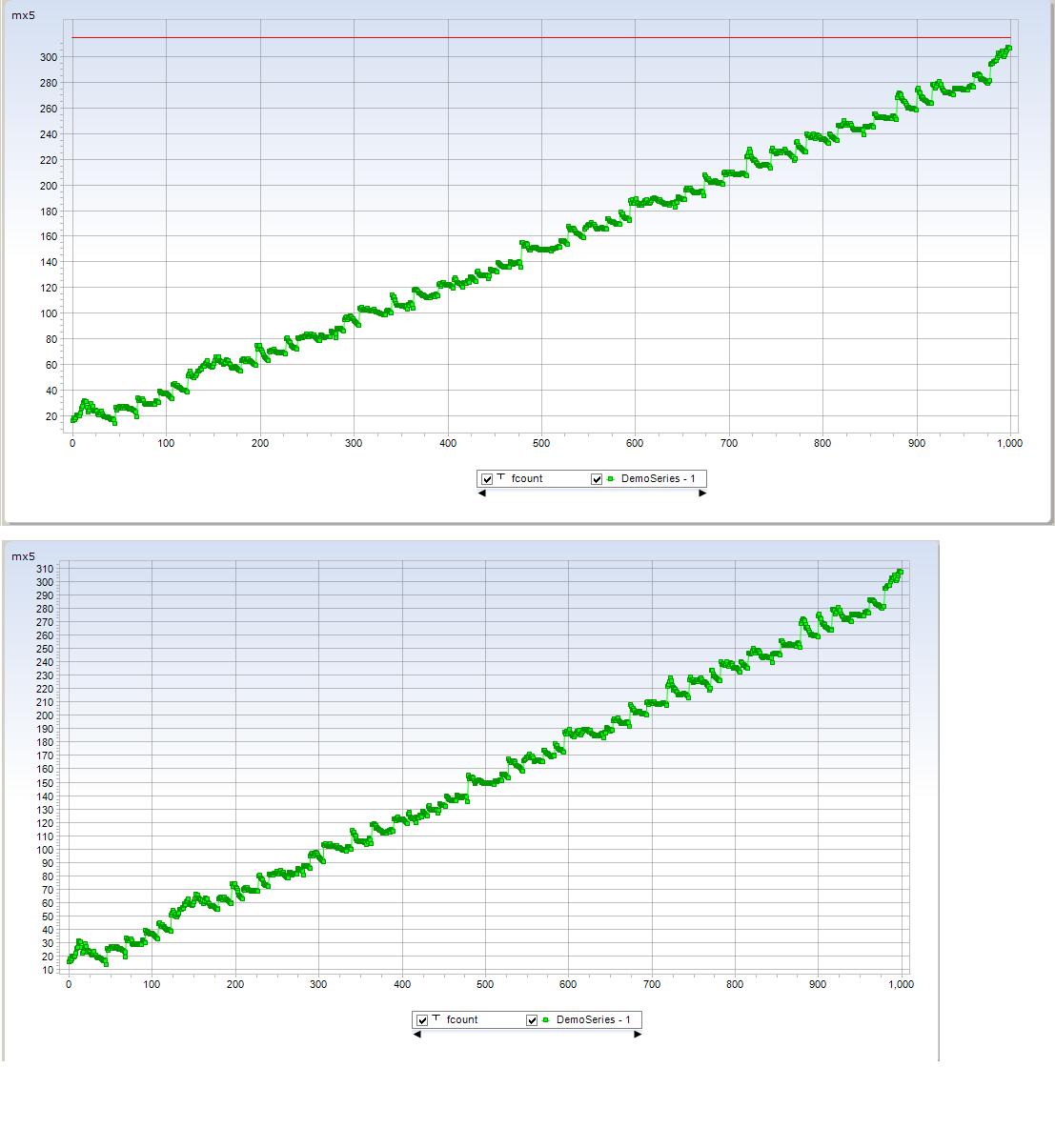

1. There is a problem in Error Bar Series Visible.
Red Series is ErrorBar.
At Chart Resize Width Change, ErrorBar Series not visible.

I'm trying to reproduce the problem with the following simple example project, but I can't:
            CreateChart();
        private Steema.TeeChart.TChart tChart1;
        private void CreateChart()
            tChart1 = new Steema.TeeChart.TChart();
            this.Controls.Add(tChart1);
            Steema.TeeChart.ChartController chartController1 = new Steema.TeeChart.ChartController();
            this.Controls.Add(chartController1);
            chartController1.Chart = tChart1;
            chartController1.Dock = DockStyle.Top;
            Steema.TeeChart.Styles.ErrorBar errorbar1 = new Steema.TeeChart.Styles.ErrorBar(tChart1.Chart);
            errorbar1.Add(500, 0, 320);
            Steema.TeeChart.Styles.Line line1 = new Steema.TeeChart.Styles.Line(tChart1.Chart);
            line1.Pointer.Visible = true;
            for (int i = 0; i < 100; i++)
                line1.Add(i*10, i*3);
            tChart1.Axes.Bottom.SetMinMax(0, 1000);
Could you please check if you can reproduce it in your machine and, if not, could you please modify it so we can reproduce the problem here?
