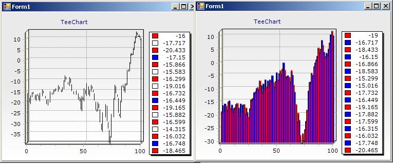

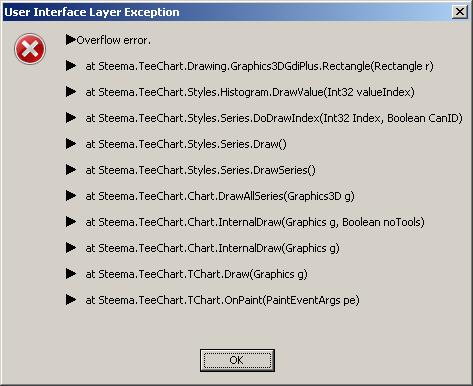

1. There is a problem In Histogram Zoom. ( Stack Overflow )
attached test code Project(HistogramTest.zip) Work In TeeChart 3.0
but TeeChart 2009 or 2010 has Problem. (stack overflow)
In My Opinion, If histogram color value count is more than 2 there is problem in Chart Screen Zoom.
2. Histogram Fill Color does not work. and Color Bar series same problem.

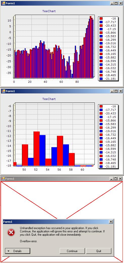

step 1 : Run
step 2 : Zoom more than 4 or 5.

Hello BISTEL,
Thanks for your explanation. I could reproduce your problem with last version of TeeChart .Net and I have added it in Bug Report list with number [TF02015029]. We will try to fix it for next maintenances releases of TeeChart.Net.
