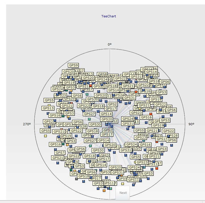

I am using polar bar series. I have 100 points in alist and each point is changing its angle w.r.t time ,and I want to join each angle of the point at different time by a line and only different angle values for given point has to connect with a line not another point's angle value, So do u have any idea how to do it?

Pls see the attached image, In this image I ahve one point name GPS3 on different angles and I want only these point to join via line not any other points. I hope u understand.

If I understood well, you want the PolarBar series to show the line for some values and not in another ones.
I'm afraid you should hide all the lines and draw the desired lines manually. Here is an example:
Steema.TeeChart.Styles.PolarBar polarbar1;
polarbar1 = new Steema.TeeChart.Styles.PolarBar(tChart1.Chart);
polarbar1.FillSampleValues();
polarbar1.Pen.Visible = false;
tChart1.BeforeDrawSeries += new Steema.TeeChart.PaintChartEventHandler(tChart1_BeforeDrawSeries);
tChart1.Draw();
void tChart1_BeforeDrawSeries(object sender, Steema.TeeChart.Drawing.Graphics3D g)
tChart1.Graphics3D.Pen.Color = polarbar1.Pen.Color;
tChart1.Graphics3D.Line(polarbar1.CalcXPos(5), polarbar1.CalcYPos(5), polarbar1.CircleXCenter, polarbar1.CircleYCenter);

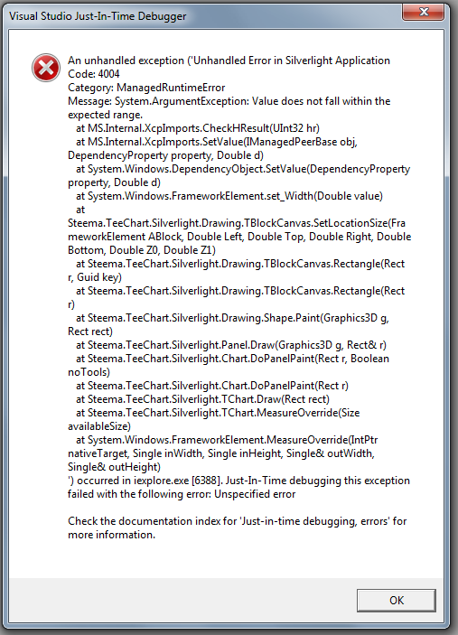

As I told in my pervious post I am using 2010 .net Eval with win 7 64 bit machine . when i tried to call Steema.Tchart .dll within my silver light application I got the following eror please see the attched screen shot. I think it not support 64 bit version. Or do u have any solution for it.

For Silverlight projects you should not use TeeChart.dll you should use TeeChart.Sivlerlight.dll. Therefore namespace and class names are also a little bit different. Can you please confirm that you are using TeeChart.Silverlight.dll?
Also notice that in x64 environments you'll have to build Silverlight applications in v86 mode which forces the use of a 32-bit browser:
http://forums.silverlight.net/forums/p/ ... 61883.aspx

I am using TeeChart.Silverlight.dll it was only the the typing mistake before. I tried to compile the project as x86 project . It throws the exception at the
Line: 54
Error: Unhandled Error in Silverlight Application
Code: 2105
Category: InitializeError
Message: Failed to load pre-requisites for the application
U have two different distribution for the .Net 2009 Steema library before one for 32 bit and other for 64 bit , it works fine with my applicatin for .Net 3.5 , but now I am migrating to :net 4 and the elevation version of steema 2010 throwing this exception. So dont u have any package for 64 bit windows machine?

Is the error reproducible creating a new simple application or only when trying to update an old one?
In the customer area you should find a 32 bits and a 64 bits dll for Win32 applications.

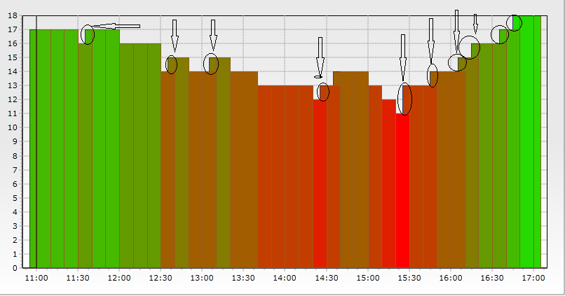

I have created an application where I am using bar series to display my result . but I found strange thing while drawing the graph there is unwanted part is attached from one bar to another bar .I tried to figure it out but didnt suced . I am attching the pic where I have circled the unwanted peaks. plz have a look and tell me whatz wrong .

Could you please arrange and send us a simple example project we can run as-is to reproduce the problem here?
It seems that you may be setting a conflictive BarWidthPercent and CustomBarWidth.
