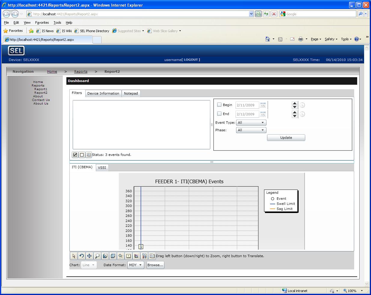

I have a simple Silverlight example that I cannot get to work. I noticed that this issue has come up before in the Forum, but I could not find out whether there is a solution, or it is a bug.
I have a tab control with two tab items. In each tab item I have a TChart control that is supposed to stretch to fill the tab item. If I assign a fixed size to the TChart control in the first tab, then the TChart in the second tab will automatically stretch. If I try to make them both stretchable, then the designer preview fails. If I replace the TChart control in the first tab item with a simple button, the button correctly stretches and so does the TChart control in the second tab item. I have tried all kinds of variations but I cannot get both TChart controls to stretch automatically. See attached code. Remove the hard coded dimensions of the first TChart control to reproduce the problem.
Can you help?

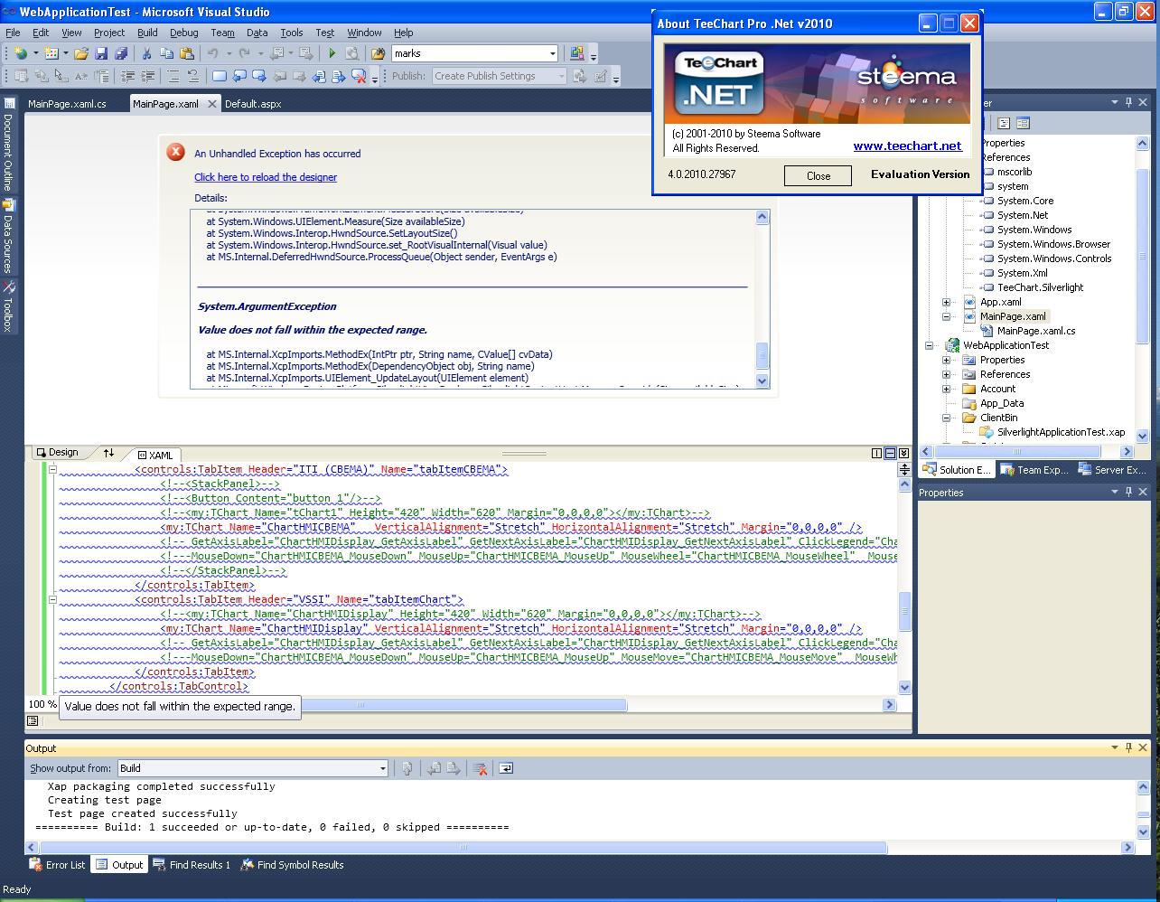

I copied and pasted your code into a new project. I am not able to load the silverlight design page in the Visual Studio designer.
I am using Visual Studio 2010 (Version 10.0.30319.1 RTMRel).
I am using TeeChart.NET (Version 4.0.2010.27967 file version 4.0.2010.27966)
I get the following error if I do not provide a Height and Width property for the first TeeChart control:
System.Reflection.TargetInvocationException
Exception has been thrown by the target of an invocation.

at System.Windows.UIElement.Measure(Size availableSize)
at System.Windows.Controls.Grid.MeasureOverride(Size constraint)
at System.Windows.FrameworkElement.MeasureCore(Size availableSize)
at MS.Internal.Helper.MeasureElementWithSingleChild(UIElement element, Size constraint)
at System.Windows.Controls.ContentPresenter.MeasureOverride(Size constraint)
at System.Windows.Controls.Control.MeasureOverride(Size constraint)
at System.Windows.Interop.HwndSource.SetLayoutSize()
at System.Windows.Interop.HwndSource.set_RootVisualInternal(Visual value)
at MS.Internal.DeferredHwndSource.ProcessQueue(Object sender, EventArgs e)
System.ArgumentException
Value does not fall within the expected range.
at MS.Internal.XcpImports.MethodEx(IntPtr ptr, String name, CValue[] cvData)
at MS.Internal.XcpImports.MethodEx(DependencyObject obj, String name)
at MS.Internal.XcpImports.UIElement_UpdateLayout(UIElement element)
at Microsoft.Windows.Design.Platform.SilverlightViewProducer.SilverlightContentHost.MeasureOverride(Size availableSize)
Snapshot of Visual Studio with error

Post by Sandra » Mon Jun 28, 2010 9:02 am
Hello BlueMonkey,
I have tested again your code and I could reproduce the problem here with TeeChart2010, and I solve it changing the name of application thus:
Code Class name:
x:Class="SilverlightApplication1.MainPage"
Change for your class name:
 x:Class="SilverlightTestApplication.MainPage"
Could you please check again if your code works when you change class name and say us if now works as you want?
BlueMonkey
Posts: 34
Joined: Tue Nov 04, 2008 12:00 am
Re: Stretchable Tchart control in Silverlight
Post by BlueMonkey » Mon Jun 28, 2010 4:44 pm
Sandra,
If I change the application name, then it does not match the content of the code behind file and I get a build error:
Error 1 The name 'InitializeComponent' does not exist in the current context
This problem seems to be specifically related to the Visual Studio design view. If I specify constant Width and Height properties, the design view appears and the application will run and display the fixed chart dimensions. If I remove the fixed chart dimensions (leaving the stretchable properties) then the design view gives the error "Value does not fall within the expected range.". However if I run the application in spite of the error in the design view, then the chart window will appear stretchable.
The conclusion is that if I want to see the design view of my GUI, I must supply fixed TChart dimensions. If I want to have a stretchable TChart in my runtime application, I must remove the fixed chart dimensions. I cannot have both.
It would be nice if the TChart would display correctly in the VS design view for both cases. Is this something you can fix?
Post by Sandra » Tue Jun 29, 2010 10:26 am
Hello BlueMonkey,
Sorry, I think that I didn't understand your previous post correctly, but now I could reproduce your problem and I have added it in bug list with number [TW24015010]. We will try to fix it in next versions of TeeChartSilverlight.
