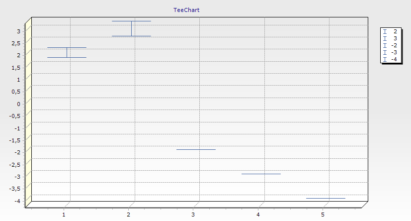

Steps to reproduce:
Imports System.Drawing
Imports Steema.TeeChart
Public Class Form1
  Private Sub Form1_Load(ByVal sender As System.Object, ByVal e As System.EventArgs) Handles MyBase.Load
    Dim errorSeries As Styles.Error
    With TChart1
      errorSeries = DirectCast(.Series.Add(New Styles.Error(.Chart)), Styles.Error)
    End With
    errorSeries.Add(1, 2, 0.2)
    errorSeries.Add(2, 3, 0.3)
    errorSeries.Add(3, -2, 0.5)
    errorSeries.Add(4, -3, -0.5)
    errorSeries.Add(5, -4, 0.25)
  End Sub
End Class
result:
For positive y values you get the expected 'H' for negative values you get an '|'
see attachement for graphical sample.
Version of TChart: 4.0.2010.13051
Visula Studio: 2005 2.0.50727 SP2
Re: Styles.Error displayed incorrect for negative Y values
Post by Sandra » Fri Jun 18, 2010 10:14 am
Hello CitoICT,
I could reproduce your problem and I have added it in bug report list with number[TF02014982]. We will try to fix it for next maintenances release of TeeChart.Net.
Post by Sandra » Thu Jul 29, 2010 9:45 am
Hello CitoICT,
I inform that bug with number (TF02014982), is not a bug. Result that appears is correct, because it behaves as designed
