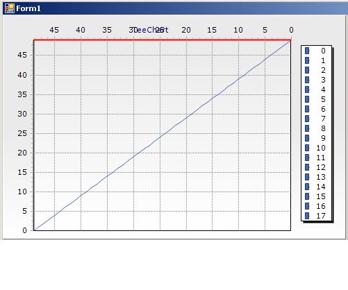

Hello.
Has bug in run and design time.
Add horizontal custom axe and set OTHER SIDE = true and add horizontal line.
In result, labels on custom axe draw in reversed order, but data on line in right order
petroV
Posts: 24
Joined: Tue Mar 02, 2010 12:00 am
Re: problem with horizontal custom axe
Post by petroV » Wed Jun 02, 2010 9:39 am
first point - x = 1010 , y = 0, but on chart, according label on custom axe, first point x ~ 800

My problem easy reproduce in design time, step by step:
1. drop Chart
In edit mode chart:
2. add horizontal line
3. add custom axe
4. custom axe set horizontal and otherside
5. and set horizontal line axe - custom axe (Custom 0).

Code for reproduce.
      double x = 0;
      double y = 0;
      Steema.TeeChart.Styles.HorizLine line = new Steema.TeeChart.Styles.HorizLine(tChart1.Chart);
      for (int k = 0; k < 50; k++)
        line.Add(x, y);
        x++; y++;
      Steema.TeeChart.Axis axes1 = new Steema.TeeChart.Axis();
      tChart1.Axes.Custom.Add(axes1);
      axes1.AxisPen.Color = Color.Red;
      line.CustomHorizAxis = axes1;
      axes1.OtherSide = true;
      axes1.Horizontal = true;

Thanks, for your example, I could reproduce your problem and I have added it in bug report list with number [TF02014929]. We will try to fix it for next maintenance releases for TeeChart.Net. For now, you could use Top axes, so next example:
            double x = 0;
            double y = 0;
                line.Add(x, y);
                x++; y++;
            line.CustomHorizAxis = tChart1.Axes.Top;
            tChart1.Axes.Top.OtherSide = true;
Post by Yeray » Mon Jun 14, 2010 1:41 pm
Hi Stefan and petroV,
The bug [TF02014929] has been fixed so it should work as expected in the next maintenance release.
