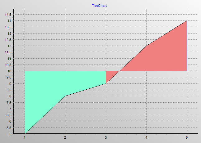

I have a question about the different colors used for a HighLow Series.
I want to color the area where High > Low value green and the area where High < Low value red.
With the following code I get more or less the result:
Steema.TeeChart.Styles.HighLow hl = new Steema.TeeChart.Styles.HighLow();
m_tchart.Series.Add(hl);
hl.Add(1, 10, 5);
hl.Add(2, 10, 8);
hl.Add(3, 10, 9);
hl.Add(4, 10, 12);
hl.Add(5, 10, 14);
hl.HighBrush.Color = System.Drawing.Color.Aquamarine;
hl.HighBrush.Visible = true;
hl.LowBrush.Color = System.Drawing.Color.LightCoral;
hl.LowBrush.Visible = true;
However, the red color already start from the point where the values ARE GOING TO cross (point 3 in my example). But in fact, I want to start the red color only from the cross point itself.
So, somewhere in the middle between 3 and 4 where the two lines actually cross. See screenshot.
Thanks for your help!
Marijke.
Screenshot

Hello Marijke,
When you use HighLow Series, and you want to paint with different colors Low and High values, you need a point exactly of values intersection.
I recommend use function CrossPoints for calculate point intersection and two Region tools to paint values of the HighLow Series. Also, you should change the order of High and low points, because region tool works with high values for change its positions. Please, see next code, and check if it works as you want.
