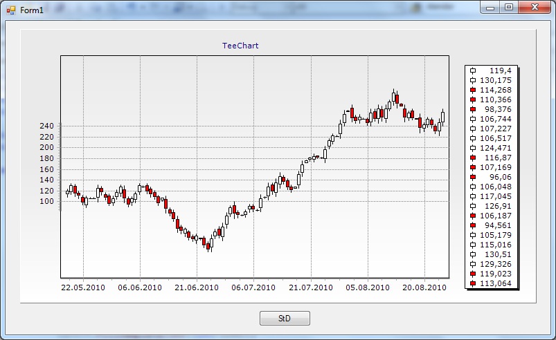

We do not need draw graph outside the axis's area (after zoom) in case, if axis does not fill whole height of the chart. Could you please answer how to do it, if it is possible?
Code of my sample is:
            Steema.TeeChart.Styles.Candle candle = new Steema.TeeChart.Styles.Candle(tChart1.Chart);
            candle.FillSampleValues((int)(100));
            candle.GetVertAxis.StartPosition = 30;
            candle.GetVertAxis.EndPosition = 70;
            tChart1.Zoom.Direction = Steema.TeeChart.ZoomDirections.Vertical;
and when I zoom chart, candles outside the vertical axis area are drawing.
Thank you.
after zoom
Re: How to prohibit to draw graph outside axis area?
Post by Narcís » Mon May 17, 2010 3:09 pm
Hi luzhetsky,
Yes, this is possible. You should do as in the All Features\Welcome !\Axes\Opaque zones example in the features demo available at TeeChart's program group.
