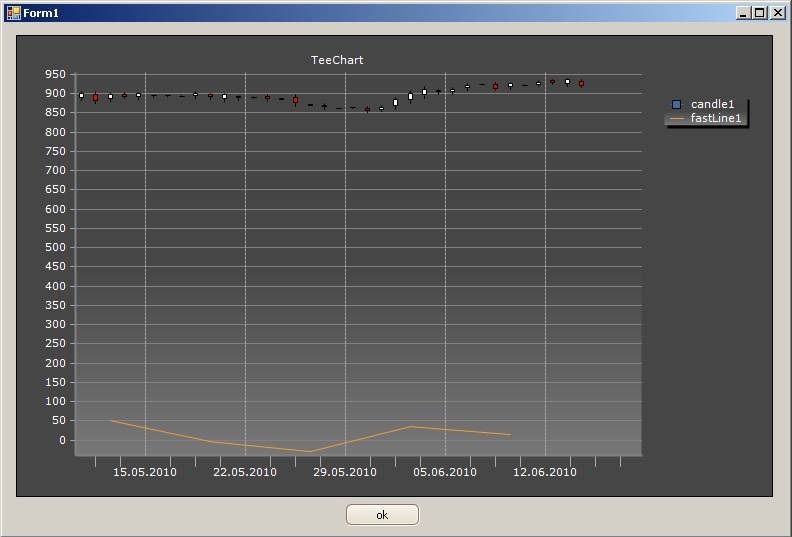

we have problem with financial functions on 4th version (4.0.2009.42283) of TeeChart lib (on 2nd version (2.0.2469.25745) it is working ok): function line is drawing incorrect - it ends not on last data point, but with some left shift, and looks like visible points calculation is wrong too - see attached screens for both versions of lib.
How it may be resolved?

- 4th version is wrong
- v4.0.2009.42283.jpg (69.73 KiB) Viewed 8898 times

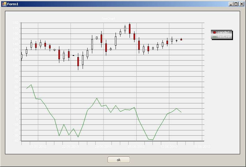

- 2nd version is Ok
- v2.0.2469.25745.jpg (82.56 KiB) Viewed 8897 times

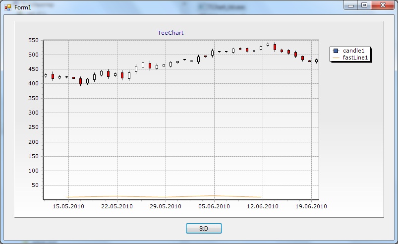

Hi Narcís!
Here is a code and result pic:
Candle candle = new Candle();
candle.FillSampleValues();
tChart1.Series.Add(candle);
StdDeviation func = new StdDeviation();
func.Period = 7;
FastLine line = new FastLine();
line.DataSource = candle;
line.Function = func;
tChart1.Series.Add(line);
- Std.jpg (86.19 KiB) Viewed 8806 times

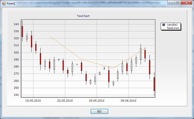

Re: incorrect financial functions behavior
Hi Narcís!
It's not working!
look at the code - I'm using 1000 values:
and here is result on screens (pic1):
and you can see on zoomed graph last value of Line is not on last value of Candle (pic2):
AND! please look that StD function should be smooth, and EACH point of it (starting from N) should be calculated based on data of previous N (N is period), but on graph I see that StD calculated only for each N points - it's incorrect!
And, THE SAME! with function High and Low (see pic. 3): line is not smooth and function is calculated only for each 7 pointh, but NOT FOR ALL POINTS, started from 7th!

- pic3: High function with period 7
- Hith.jpg (88.22 KiB) Viewed 8770 times

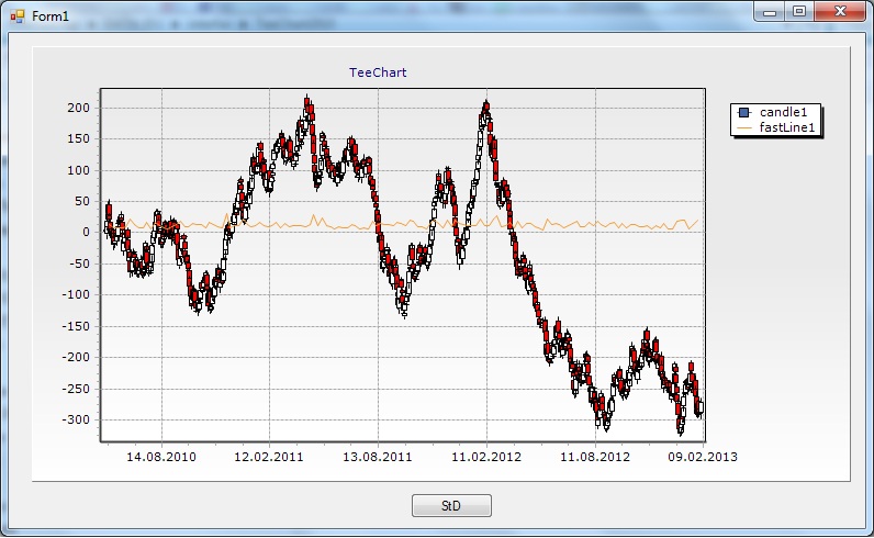

- pic2: zoomed
- Std_1000Values_zoomed.jpg (113.36 KiB) Viewed 8768 times
- pic 1: 1000 values and StD - full
- Std_1000Values_full.jpg (109.91 KiB) Viewed 8767 times

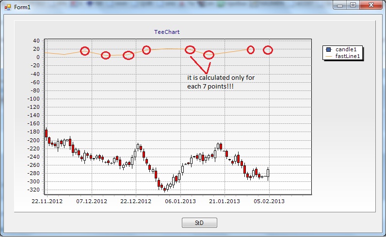

Hi luzhetsky,
For more information please read Steema.TeeChart.Functions.Function.PeriodStyle's entry in TeeChart's help file.
1000 is not multiple of 7, according to what I told you before, it works fine with 994 or 1006 pointsand you can see on zoomed graph last value of Line is not on last value of Candle (pic2):
This depends on PeriodStyle property. Setting it to PeriodStyles.Range does the job:AND! please look that StD function should be smooth, and EACH point of it (starting from N) should be calculated based on data of previous N (N is period), but on graph I see that StD calculated only for each N points - it's incorrect!
func.PeriodStyle = Steema.TeeChart.Functions.PeriodStyles.Range;
