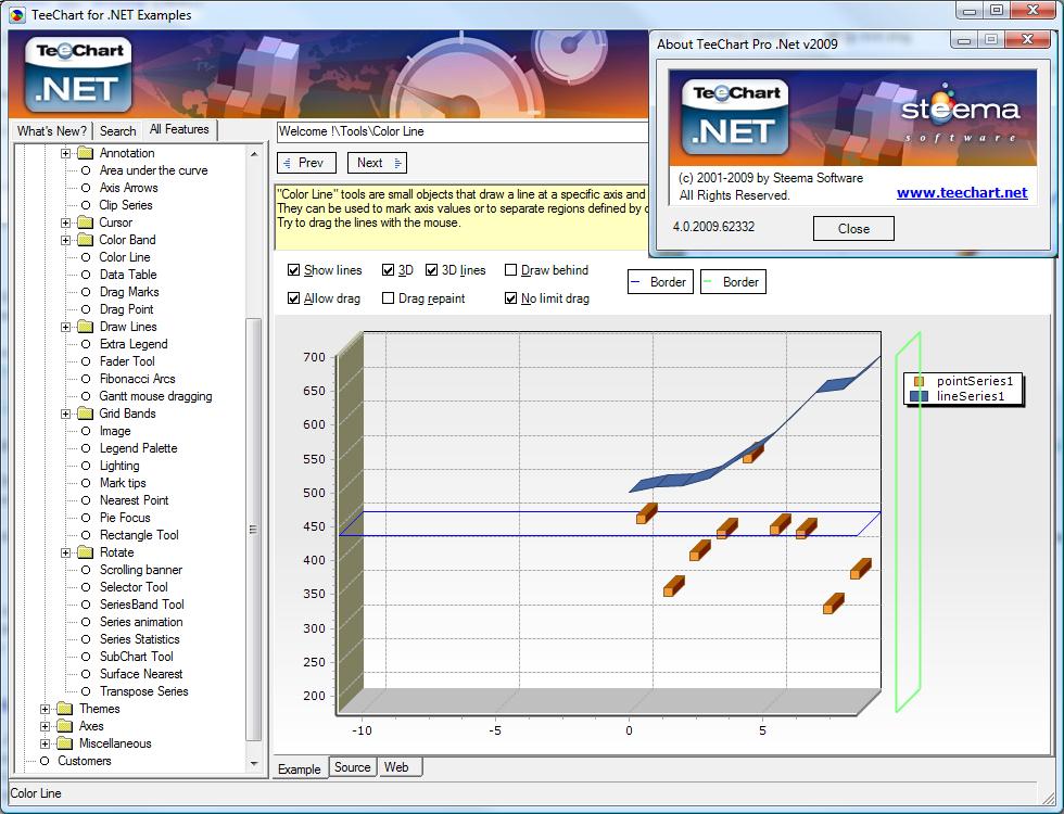

Re: TChart Issues II
re: Color Line issue
see attachment. Note, demo was run under Vista and I think the problem is seen under Windows 7 as well.
Hello Mark,
I understand that when ColorLine is NoLimitDrag=True, and drag it outside the boundaries of chart, it is painted over of Legend. Could you confirm that is it your problem?

In the case of the demo the answer is 'yes'. However, the generalized case is that the ColorLine is rendered outside the boundaries of the chart when the ColorLine position is beyond the axis limits currently displayed on the chart. I hope this has explained the problem sufficiently.I understand that when ColorLine is NoLimitDrag=True, and drag it outside the boundaries of chart, it is painted over of Legend. Could you confirm that is it your problem?
