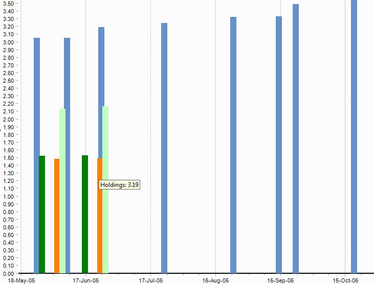

I tried your sample and that one works fine. The problem I have is that in my situation the different series bars overlap (as in the attached example) and they are not side by side like in your sample (although I set the MultiBar property of the series to MultiBars.Side). When I hover the mouse cursor over an area where two series overlap - the tool tip oscillates between the values of the overlapping series. If I hover over a series that doesn't overlap - I have no problems.

- SeriesOverlap.jpg (43.21 KiB) Viewed 12422 times
