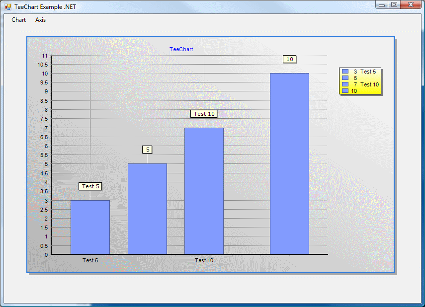

I have an issue with the order of my labels in the chart series points.
I add 4 data points where the X Values are not in the order in which they are going to appear in the chart.
The points in the chart series are in the correct x-order, but the labels for those points are the labels as added in the code, and do not follow the order of the data points.
A small example will clarify my problem:
Steema.TeeChart.Styles.Bar bar = new Steema.TeeChart.Styles.Bar();
m_tchart.Series.Add(bar);
bar.Add(5, 5, "Test 5");
bar.Add(3, 3, "");
bar.Add(10, 10, "Test 10");
bar.Add(7, 7, "");
So, the order of the points in the charts is by x value, being 3,5,7,10
But the first point in the chart will get label "Test 5", the second point will have empty label, the third point will have label "Test 10" and so on.
See the screenshot for the resulting chart.
How can I solve this?
Many thanks,
Marijke.
Screenshot

Hi Marijke,
I've reproduced it and added to the defect list to be fixed in future releases (TF02014710). In the meanwhile you could set the series XValues order to None before adding your points:
bar.XValues.Order = Steema.TeeChart.Styles.ValueListOrder.None; //workaround
bar.Add(3, 3, "");
bar.Add(7, 7, "");
Re: Order of Labels
Post by Yeray » Fri Apr 09, 2010 11:08 am
Hi Marijke,
After reviewing this, we don't consider it to be a bug but an expected behaviour for design reasons. Sometimes, one would like to add labels in order and sometimes not and TeeChart needs to know if the order of addition matters or not.
