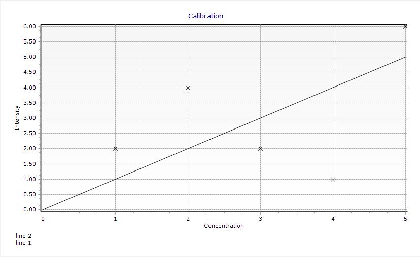

1. When multiple lines (eg. "line 1 \n line2") are added to the Header or Footer as one string the lines are display in reverse order. See example 1.

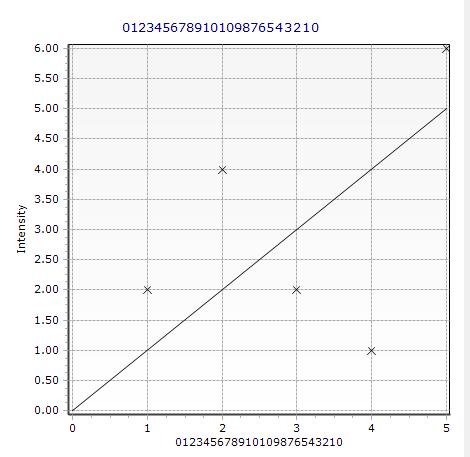

2. The Header and Footer do not align in the center of a chart when the StringAlignment.Center is used programtically. See example 1.

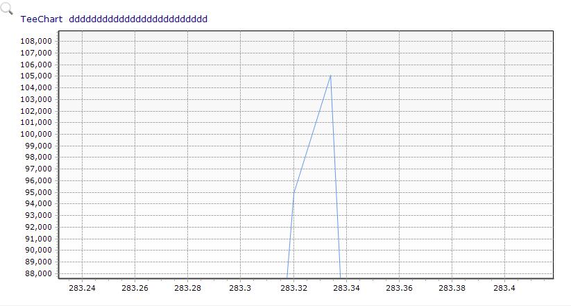

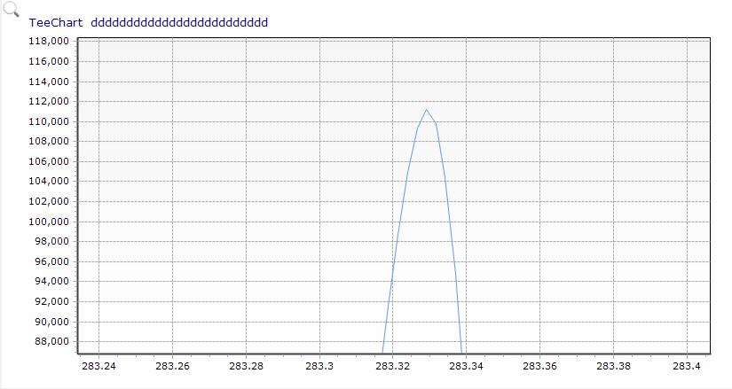

10. If the Line.Smoothed property is set to True before the series has been added to a chart an exception is thrown.

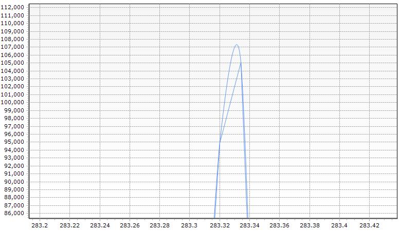

11. An additional line series is added to the chart series collection when a line series Smoothed property is set to True. This is confusing and make the usage of TChart more complex. For example, a user scenario with our application may have 10 or more Line series per chart and all of them optionally smoothed. With the currrent TChart smoothed data design our application has to handle 20 Line series when only 10 was added. Only the application code should add or remove a series to/from the series collection. The need for an additional "smoothed data" series by TChart should be hidden from the application code.
Edit: This problem is seen very clearly when an export to text is performed of a chart that has smoothed series. The export file will contain the smoothed and unsmoothed data while the user is only expecting one of the other not both. The chart only displays the smoothed.

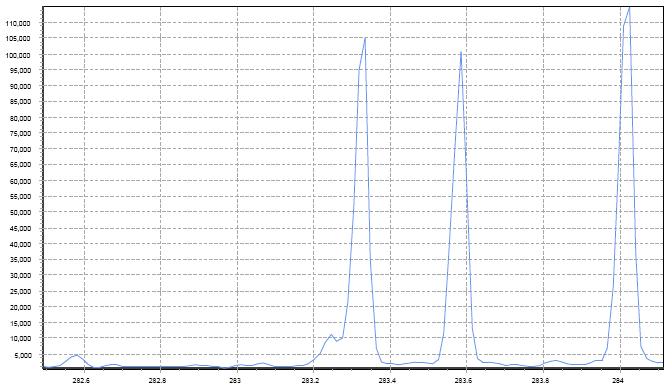

12. It appears the smoothed line needs more line segments when it is drawn. Please look at the two attachments "Unsmoothed" and "Smoothed". Our customers expect a more rounded top to the peak. Our previous graph component (our modified NPlot) achieved this very nicely using System.Drawing.DrawCurve.
Edit: I have looked at the TChart source code and the poor smoothing with my test data is due to the limit of 600 smoothed points in the Spline.Fragments property. Although I appreciate the need to set a limit, IMO a limit of 600 is too low. The degree of smoothing is reduced the more original data points there are.

- example 1.jpg (41.85 KiB) Viewed 13526 times
- Unsmoothed.jpg (57.58 KiB) Viewed 13450 times
- Smoothed.jpg (48.56 KiB) Viewed 13422 times

I could reproduce your problem. I have added it to the bug list [TF02014706] to be fixed for future releases.10. If the Line.Smoothed property is set to True before the series has been added to a chart an exception is thrown.
11 and 12:11. An additional line series is added to the chart series collection when a line series Smoothed property is set to True. This is confusing and make the usage of TChart more complex. For example, a user scenario with our application may have 10 or more Line series per chart and all of them optionally smoothed. With the currrent TChart smoothed data design our application has to handle 20 Line series when only 10 was added. Only the application code should add or remove a series to/from the series collection. The need for an additional "smoothed data" series by TChart should be hidden from the application code.
I recommend that see TeeChart.Net Demo concretely All Features\Welcome !\Functions\Extended\Smoothing function and look at the property factor. It allow change the smooth of the function as you want.
I think that you can use it, because internally smoothed property of line series use a smoothing function.
Yes, I have added it to list bug report with number [TF02014707]. We will try to fix for next versions of TeeChart.Net13. The ColorLine.Pen.Style only seems to render a non solid line if the width is set to a value greater than 1. That is, our application needs a fine dotted vertical line on the chart but it seems this is not possible as it renders as a fine (Width=1) solid line or a fatter (Width=2) dotted line. Is this a bug?

re:
tChart1.Header.Text = "012345678910109876543210";
tChart1.Header.Alignment = StringAlignment.Center;
tChart1.Axes.Bottom.Title.Text = "012345678910109876543210";

thanks for the detailed reply. I'm currently using TeeChart.dll version 4.0.2009.62332.
re:
You need to use longer text. I have only set the Header and XAxis to Center. Please see "header not centered.jpg". I have resized the chart window to show the difference more clearly.2. The Header and Footer do not align in the center of a chart when the StringAlignment.Center is used programtically. See example 1.

- header not centered.jpg (28.7 KiB) Viewed 13345 times

tChart1.Header.Alignment behaves as expected according to the design because calculate the alignment respect to all the chart unlike tChart1.Axes.Bottom.Title.Text, that calculate alignment respect BottomAxis, why the position is different.You need to use longer text. I have only set the Header and XAxis to Center. Please see "header not centered.jpg". I have resized the chart window to show the difference more clearly.

Please have a look at the attachment "new smoothed.jpg" and compare it with the attachments I posted in a previous post.
However, I have two problems.
The first problem, is to do with PDF export. Please see the attachment "new smoothed pdf output.jpg" only the values from the series are displayed - no smoothed curve.

Please see next code and check if works as you want.
I must communicate, that bug with number (TF02014707) is not a bug. Basically, the problem, of are not seeing differences of the ColorLine.Pen.Style.X when Width=1, is because Chart is by default SmoothingMode.HighQuality, but if it is changed SmoothinMode, the ColorLine.Pen.Style.X works well. Please see next code and check if works if you want.13. The ColorLine.Pen.Style only seems to render a non solid line if the width is set to a value greater than 1. That is, our application needs a fine dotted vertical line on the chart but it seems this is not possible as it renders as a fine (Width=1) solid line or a fatter (Width=2) dotted line. Is this a bug?
Steema.TeeChart.Styles.Line line1, line2;
Steema.TeeChart.Tools.ColorLine colorline1;
line1 = new Steema.TeeChart.Styles.Line();
line2 = new Steema.TeeChart.Styles.Line();
//-----Problem occurs for next----//
tChart1.Graphics3D.SmoothingMode = System.Drawing.Drawing2D.SmoothingMode.HighQuality;
//--------Solve problem for next-----//
//tChart1.Graphics3D.SmoothingMode = System.Drawing.Drawing2D.SmoothingMode.HighSpeed;
line1.FillSampleValues(10);
line2.FillSampleValues(10);
tChart1.Series.Add(line2);
colorline1 = new Steema.TeeChart.Tools.ColorLine(tChart1.Chart);
colorline1.Axis = tChart1.Axes.Bottom;
colorline1.Pen.Style = System.Drawing.Drawing2D.DashStyle.Dot;
colorline1.Pen.Color = Color.OrangeRed;
colorline1.DragRepaint = true;
colorline1.Pen.Width = 1;
tChart1.Footer.Visible = true;
tChart1.Footer.Text = "line1\n" + "line2 \n";
tChart1.Footer.Alignment = StringAlignment.Center;
tChart1.Header.Visible = true;
tChart1.Header.Text = "line1\n" + "line2 \n";
