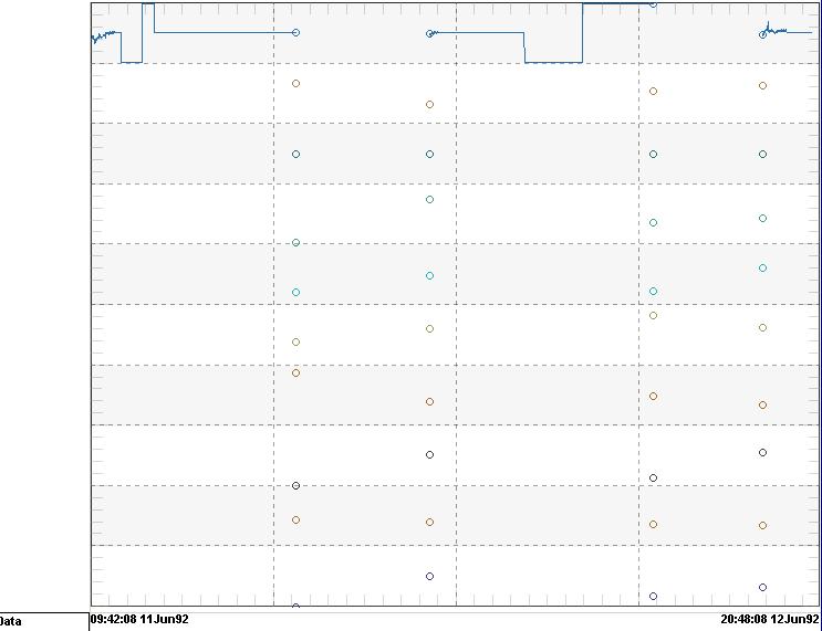

I have subscribed to the BeforeDrawValue event of Each of the fastline series.
But only the 1st fastline series is getting drawn. All other series are not drawn.
See the screen shot below -

Re: Clamp data after Setting the Min Max of custom axis
Post by Narcís » Mon Feb 15, 2010 6:29 pm
Hi Avijit,
Ok, now I understand which is the exact problem. In that case you should do as in the All Features\Welcome!\Axes\Opaque zones and use ClearClipRegions in the AfterDraw event.
