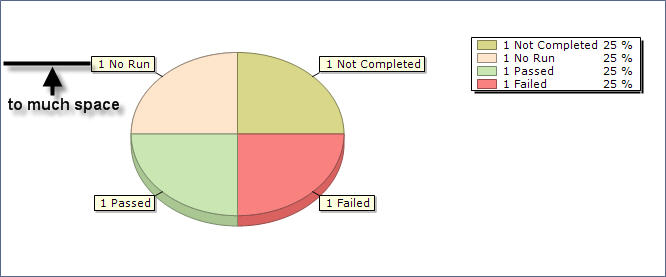

I have a problem where the pie has too much space between its' start (on the left) and the actual border of the panel (I've added an image to demonstrate).
Could you please advice me on how to control that space or eliminate it all together.

Re: Extra white space in pie
Post by Sandra » Thu Feb 11, 2010 10:13 am
Hello gcrnd,
I found a simple code that I think you could use in your application to control space there are between pie and margins. Please, check next code works as you want:
        private Steema.TeeChart.Styles.Pie pie1;
           //tChart1.Legend.Visible = false;
            pie1 = new Steema.TeeChart.Styles.Pie(tChart1.Chart);
            pie1.FillSampleValues(4);
            tChart1.Draw();
            int w = tChart1.Legend.Visible ? tChart1.Legend.Left - rect.Left : rect.Width;
            pie1.CustomXRadius = (w / 2) - getWidestMark(pie1);
            pie1.CustomYRadius = rect.Height / 2;
        private int getWidestMark(Steema.TeeChart.Styles.Series s)
            int tmp = 0;
            if (s.Marks.Visible)
                for (int i = 0; i < s.Marks.Positions.Count; i++)
                    tmp = Math.Max(tmp,s.Marks.Positions[i].Width);
            return tmp;
