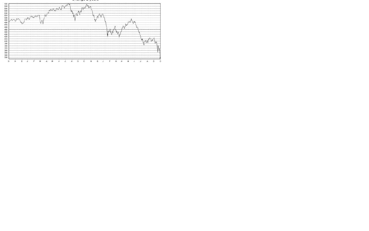

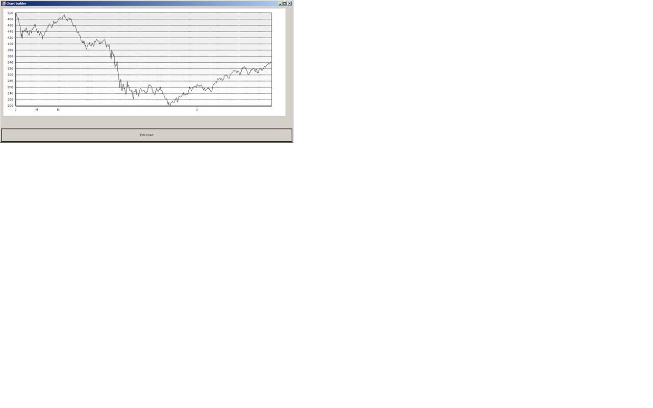

For some years now we create a specific chart see below chart and data. Since we are using the teechart . net V3 for visual studio 2008 we are see that not all labels are displayed on the bottom axis. Is there some changed functionality in version 3?

- image of chart with complete bottom axis
- previous.JPG (39.47 KiB) Viewed 11503 times
- image of chart with incomplete bottom axis
- vs2008.JPG (40.92 KiB) Viewed 11503 times

Thanks for the example project. I could reproduce the issue here. I checked it works fine in TeeChart for .NET v1 and v2 but fails in v3 and 2009. I've added the defect to the list to be fixed with ticket number TF02014629.
In the meantime, a workaround is using custom labels, for example:
Hope this helps!
