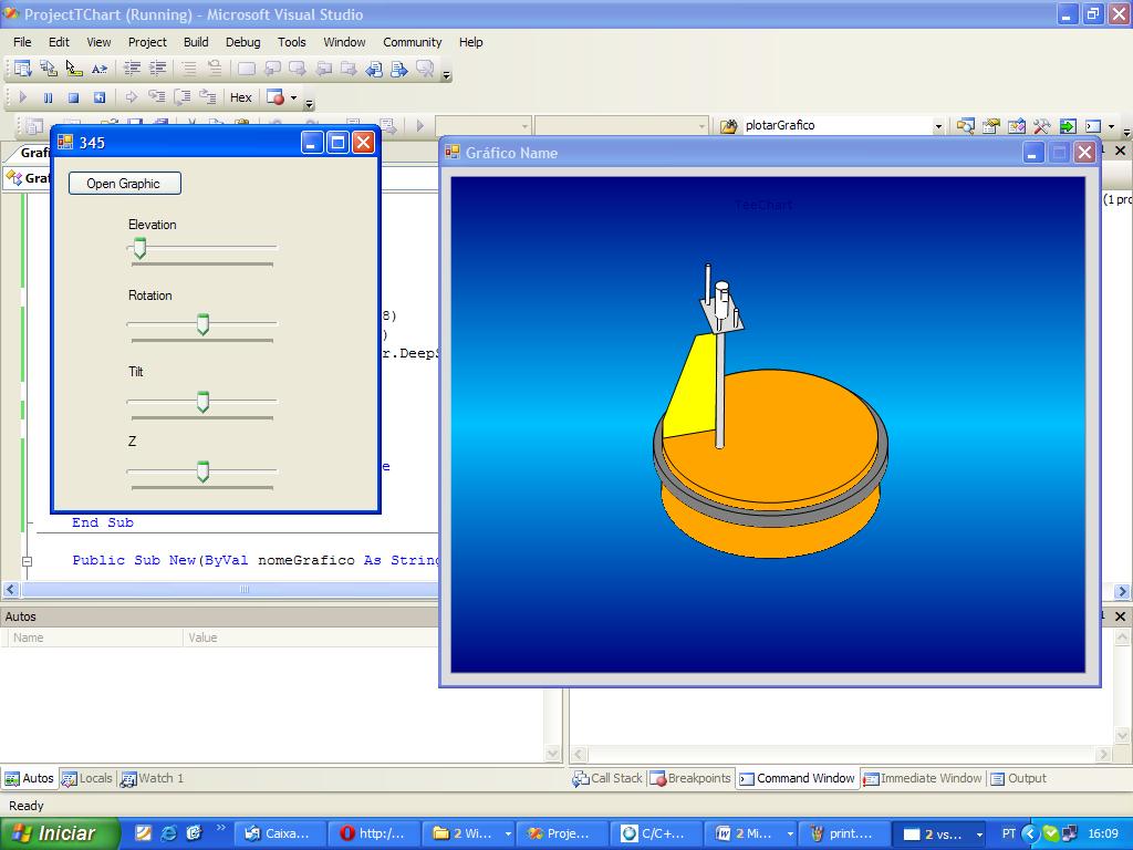

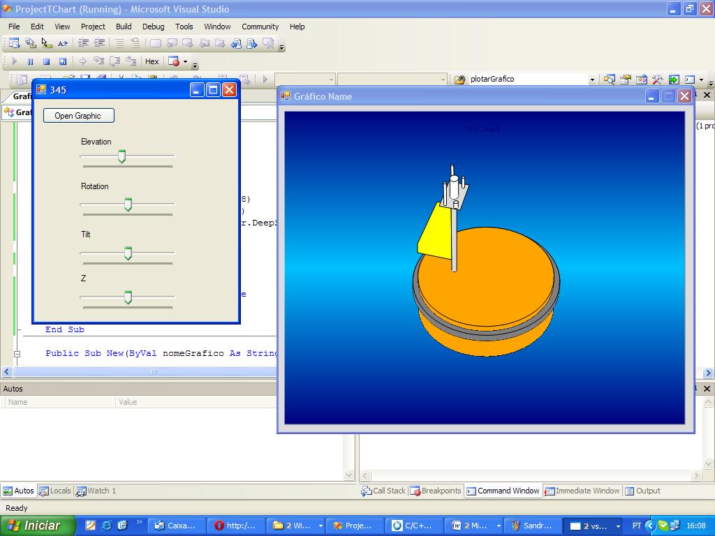

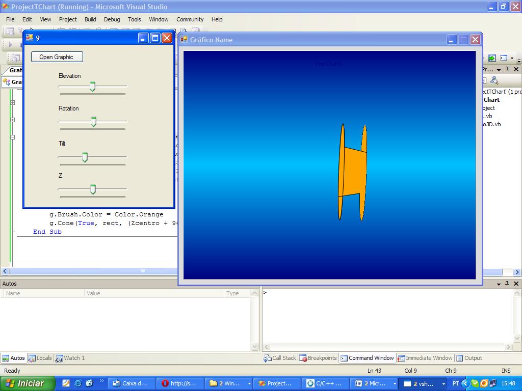

Now I attached some pictures.
The trackbar values are going from -360 through 360.
The bottom of the object that I drew never appears.
Thanks!
Problem Elevation.
Problem Elevation. Note the white cylinders on the top.
problem of tilt using the Sandra's example.

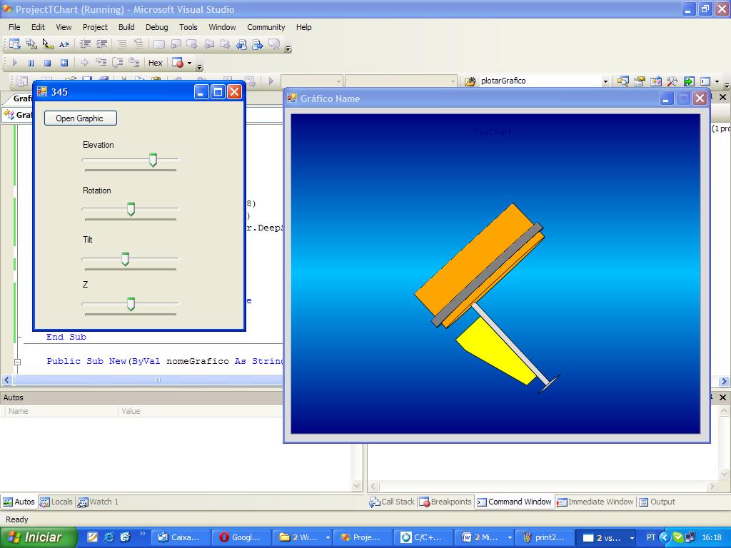

Post by "Alias" » Tue Jan 12, 2010 7:08 pm
Another image.
Tilt problem. The cylinders of the top just disappeared.
