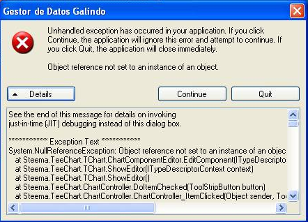

I developed a program which open charteditor, it runs sucessfully in the developer computer, but I installed it in a user computer the chart is seen successfully but when I try to open chart editor it shows this error.
I forgot to add something in the installer?
Thanks in advance

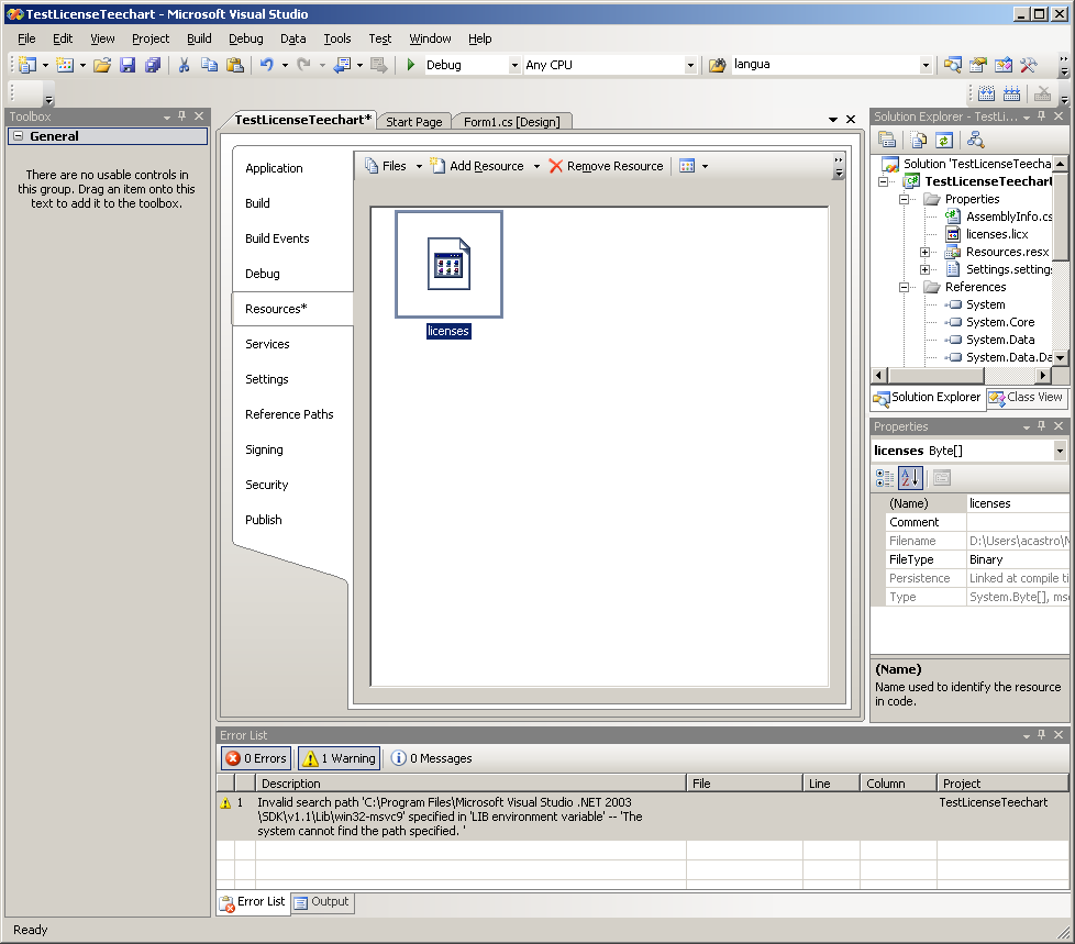

Narcís wrote: licenses.licx should be compiled in your application as an embedded resource. Please check how it is set up in the examples shipped with the installation.
I attached a screenshot, is that the way to add as an embedded resource?
Narcís wrote: If the problem persists please send us a simple example project we can run "as-is" to reproduce the problem here and let us know the exact TeeChart version you are using.
I attached a simple example project, I can open it in the client computer but when I push in the chartController the button to show the chartEditor it shows the error.

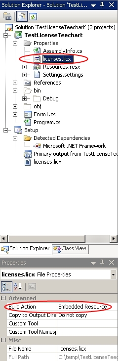

No, it's as shown in the image below, as in the example projects I told you. You already had it correct
run successfully, but I have still the error when I push the button in chartController... :(
Just had to reassign TeeChart.dll reference to your project, build it, both in debug and release mode, and deployed application's *.exe and TeeChart.dll to a machine without TeeChart installed and could run it successfully. Can you please try deploying the application as I did?

Narcís wrote: No, it's as shown in the image below, as in the example projects I told you. You already had it correct
I see a difference between your setup project and mine. I have the TeeChart.dll file in "Detected dependencies". Could it be related with my problem?
Narcís wrote: Just had to reassign TeeChart.dll reference to your project, build it, both in debug and release mode, and deployed application's *.exe and TeeChart.dll to a machine without TeeChart installed and could run it successfully. Can you please try deploying the application as I did?
I have just deleted TeeChart.dll from the references, and I added it manually, I rebuilt the teechart project and the setup project but the error remains :(
