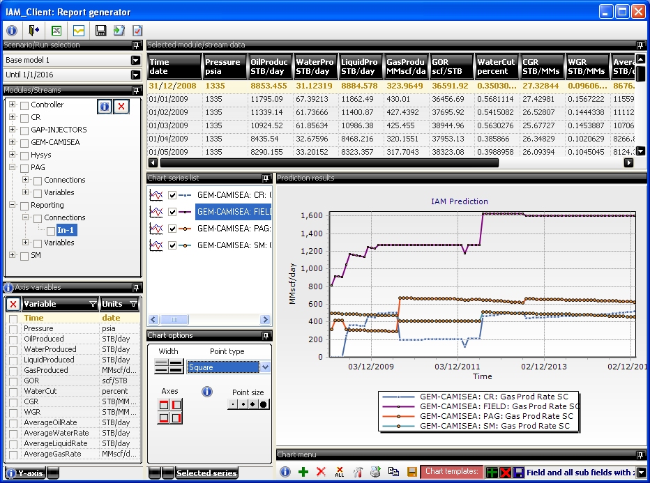

Thanks for your reply. My chart's context is too complex to provide a simple example, but I have observed something new:
If I undock the chart without ever having caused the MarksTip to be displayed, and then hover the mouse over a series, the MarksTip works fine. However, when I redock the chart, the MarksTip doesn't display - basically the opposite of the problem I described before. If I then undock it again, the MarksTip works.
This behaviour continues until I close then reopen the form containing the chart. So, depending on when the MarksTip is first displayed, it will only ever be displayed there in future.
I have attached a screenshot to help you understand the chart's environment.
