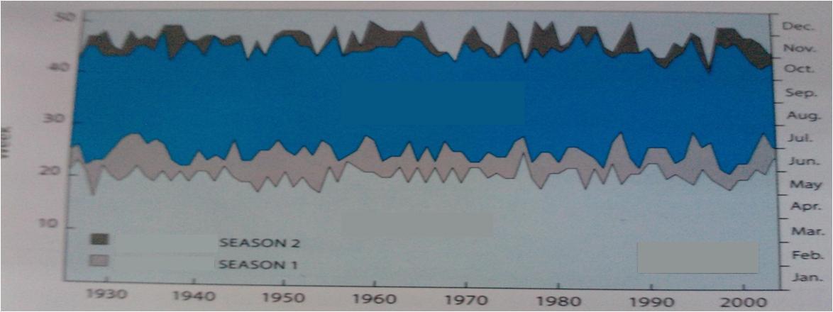

Dear All,
I have a sample chart as in the attachment with 4 series. I would like to plot them like as in the attachment and plug-in with colours like this.
Could you please advise if there is any way of doing this. I am doing C# and my TChart version is 1.1.1544.23908
I really appreciate if there is any advice or suggestions.

Re: Can TChart plot chart like this
Hi Leng,
Yes, this can be easily achieved using multiple Area series in your chart. You'll find similar examples at All Features\Welcome!\Chart Styles\Standard\Area in the features demo. I also recommend you to check out Tutorial 6 - Working with Series which shows how to create and use series in TeeChart and how to customize their colours. Regarding DateTime axes please read Tutorial 4 - Axis Control. Tutorials and features demo can be found at TeeChart's program group.
Hope this helps!

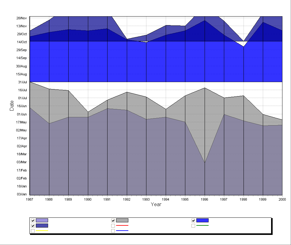

Thank you. I was trying that and the colour in the middle (the blue one) does not really connect to each other nicely when I use origin value. There are white spaces in between even I am trying to connect from the max of the previous series.
I want the blue area seen nicely as the middle area not just like this as in the above posted chart. Could you please advise?
Hello Leng,
I recommend that if isn't necessary use origin in your application, put area1.origin= false and use area1.MultiArea= Steema.TeeChart.Styles.MultiAreas.Stacked. Please see next simple example,try to made a similar code using your data and check if it works as you want.
If this don't works as you want, please explain exactly how are you want the chart, because we could help you. On the other hand, actually exist new versions improved of version 1, for example version of we works, version 2009 of TeeChart.Net (version 4 of TeeChart .Net).
Hello Sandra,
Thank you very much. I would like to have the year on X axis and Date (DD/MM) on the Y axis. I have 4 sets of data in which we can use for plotting and I would like to have the result similar to my first message post chart. I was trying the stack but it does not seem to work well. We can remove the week-out from the example chart that I have so that we can use only a single left axis.
I am trying to stack on the top of each other but it does not seem to give the same result as the chart I posted in my first message. Please find the attachment of data and let me know your advice on how that can be done.
LG
LG
Dear LG,
The problem here is that you are stacking DateTime values meaning they will sum up and therefore you'll get huge DateTime values. To see both series you should set left axis minimum value like this:
However, a chart stacking DateTime values doesn't make much sense to me. Could you please describe in detail which kind of data your series will have as X and Y values and how would you like them to be plotted or give us more detailed information on what the original image you sent represents and we will try to arrange an example for you?
tChart1.Axes.Left.AutomaticMinimum = false;
tChart1.Axes.Left.Minimum = DateTime.Parse("01/01/1950").ToOADate();
