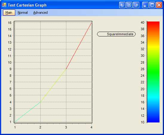

I installed the latest version of TeeChart v3 recently (3.5.3575.14456). Since then I have an exception in my application, from the moment I use a SubChart and the size needs to be adapted.
In our application, we use a subchart that is always positioned on the right side next to our main chart, which is used as a coloring legend. As shown in this screenshot of one of my test programs:
Screenshot of usage
The right coloring legend is using a subchart with a horizontalbar in it. Whenever the main chart resizes, the position and size of the coloring legend is also adapted. Since the new version, whenever I change the size of the main chart, the program throws an exception which is coming from deep down in your drawing routines.
I've attached some simplified sample code that mimics the problem. You just have to add the form to a visual studio solution and run it. The form contains a subchart, with the code to adapt the position and size.

Can you please let me know what is causing this problem in your new version?

I suppose you already know about LegendPalette Tool and you need more control than what this tool offers you and that's why you are using SubChart Tool to draw a legend.
I'm afraid I couldn't reproduce your problem. Could you please send us a simple but complete solution we can run as-is to reproduce the problem here?

Indeed. I know of the LegendPalette, but we need more flexibility, so that's why I developed a custom legend around a subchart.
I tried the latest version of TeeChart now, and the problem is still in there. The main source code was already in my first post. I uploaded a complete copy with solution and build output now to my webspace: http://users.edpnet.be/avathar/NMDG/Win ... ation1.zip.
There are problems in the SubChart of TeeChart now for a couple of months. I first reported a similar problem with the SubChart in June, and since then we cannot use any recent TeeChart release of v3 because of this exception (ticket TF02014293 was generated when first reporting problems). Back then, the problem was also in the v2009 release.

I'm not able to reproduce the problem using your project and latest TeeChart for .NET v3 update build (9th December 2009) available at the client area nor using latest v2009 release. It also works fine using the *.exe in your zip package. Can you please confirm you are using the 9th December build and if we should perform any additional step, besides running the project, to reproduce the issue?

Yeah... I even went to the latest version v3 version now (3.5.3700.30575). Every time I run this app, then just maximize the form, I get the exception.
You should be able to just see it when you run the WindowsApplication1.exe in the bin\Debug folder (I uploaded a new version with more recent TeeChart version). Still downloadable from http://users.edpnet.be/avathar/NMDG/Win ... ation1.zip.
I don't know whether it is related to machine etc. I run it on Windows XP SP3 32-bit, with .NET framework 2.0 SP2. The machine is an Intel Core 2 Duo. I will try to run it once on some other machines here to see if I can find a correlation or not.
Btw... I recently posted another topic (http://www.teechart.net/support/viewtop ... =4&t=10840). You guys suggested to me to set the BufferStyle to DoubleBuffer. When I do this to this app as well, the problem is also gone here. However, I do not want to do this since that's a performance killer.

Thanks for the example project. I have been able to reprodudce the issue here using both v3 and v2009 and added it to the defect list (TF02014723) to be fixed for future releases.
