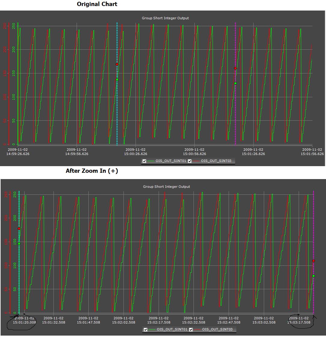

I am using teechart .net to draw my chart. And I have a problem about zoom technical. Could you help me?
- Original chart I have 601 points and I set Increment for bottom axes is 120.
- After I zoomed in, I set bottom increment is 1. But I beginning time and end time are not matched with the first point and the end point of chart.
I am using C#.net. Please, answer me as soon as possible.
Thank you very much
Here is image

Post by tomking » Tue Nov 03, 2009 1:19 am
Here is sample.
I just want like this: when I zoom in (+) the first point 's label and the last point 's label must be displayed.
