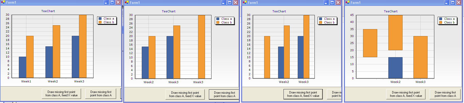

The follwing image is explained below:
03-04-2011 11-24-09.png (28.74 KiB) Viewed 19475 times
The first example shows the correctly aligned chart with two series "class a" and "class b". both series have the same number of points and are created with the following code.

The second example shows the same data but now the first point of "class a" has been removed the bar is created with the following code. This chart shows the second bar of "class a" has sliped down to week 1. Also note the error in the labels onthe bottom axis.

The third example shows the same data as the second but with a hard coded Y value, created with the following code. Note now that the bars are in their correct position but the label from the first group "Week1" is missing.

The final example is what happens when you change stacking from "side" to "stack" using the previous example.
Can you provide a suitable workaround for these problems, better still can you fix TCHART so that it correctly draws and aligns bars, and lines that have text based labels and no numerical order.

You can implement this by including fixLabels() at the end of the button2 click event. To try a different add method use
 bar = New Steema.TeeChart.Styles.Bar(TChart1.Chart)
      bar.MultiBar = MultiBars.Side
      bar.Marks.Visible = False
      bar.Title = "Class a"
      Dim ipoint As Integer
      ipoint = bar.Add(10)
      bar(ipoint).Label = "Week1"
      'ipoint = bar.Add(11)
      'bar(ipoint).Label = "Week2"
      ipoint = bar.Add(12)
      bar(ipoint).Label = "Week3"
      'bar.Add(0, 10, "Week1")
      ''bar.Add(1, 11, "Week2")
      'bar.Add(2, 12, "Week3")
      bar.Title = "Class b"
      ipoint = bar.Add(0, 20)
      ipoint = bar.Add(1, 21)
      ipoint = bar.Add(2, 22)

Re: Bar Series Question
Post by Sandra » Mon Apr 11, 2011 2:59 pm
Hello Captell,
Sorry for the delay.
These options don't allow stacking to work
bar.Add(10, "Week1")
bar.SetNull(0)
bar.Add(10, "Week1",Color.Transparent)
However bar.add(10,0,"Week1") does allow stacking to work ok.
I suggest you setting Y value to zero in the same moment you do SetNull() using same index to both cases, as do in next lines of code:
        bar.SetNull(0)
        bar.YValues(0) = 0
the xvalues are automatically set as sequential starting from 0, so if my first series has "week1" and "Week3" i.e. missing "week2" the xvalues are 0 and 1. If a second series has "week1", "week2" and "week3" the fixLabels routine needs to insert a "spacer" between "week1" and "week3" of the first series. Unfortunately, I can't find an ADD overload that will do this. If, on the other hand, I add the data using bar.Add(0, 20, "Week1") overload, i.e. I set the Xvalue myself and for the first series I leave a gap for "week2", i.e. the xvalues are 0 and 2 the fixLabels routine works fine. The problem is that I don't know what my data is until the user creates each series so I can't leave a gap. Can you suggest an ADD overload that will INSERT a bar? Or do you have another solution to this problem.
The bar of series, that corresponds of label week3, doesn't change its position because you need change XValue() to value of position of label week3, summing one to XValue() to achieve the correct position the point of the bar. So, I have modified your code FixLabels() and now works fine for me here:

On the other hand, I recommend you are very careful using method of FixLabels(), so you are manipulated index of series and values of series and it can cause some problems.
