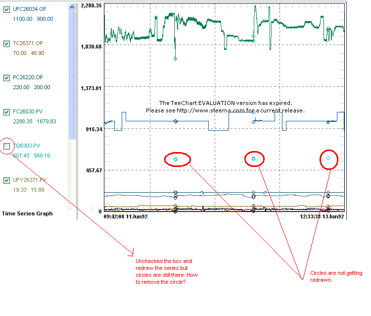

I have 10 fast line series. In each of the series, if there is a null value then i am drawing one custom circle to show the start and end of the null values.
Now, from legend control, when i am unchecking the series - means making the series as invisible, the series goes off but the circles remains there.
How to solve this problem?
I am drawing those circles on beforedrawSeries event using the Graphics3D object.
Please help.
See the image below -
[img]
[/img]

Before doing the drawing in the BeforeDrawSeries event I'd check if that specific series is visible (FastLine.Visible or FastLine.Active) and only do the drawing if series is visible otherwise don't do that.

I am drawing all the series by default. Then from legend control (not teechart legend) it raise an event when the check box is changed. Based on that i am making the series visible or invisible. But the circles are custom drawn. With the series goes invisble, the circles are not going off.
Please have a look into the code below -

Code below works fine for me here without the need of refreshing the chart. Using the AfterDraw event instead of BeforeDrawSeries also works fine. Does this code works fine for you? If the problem persists please attach a simple example project we can run "as-is" to reproduce the problem here.

This worked for me as well.
