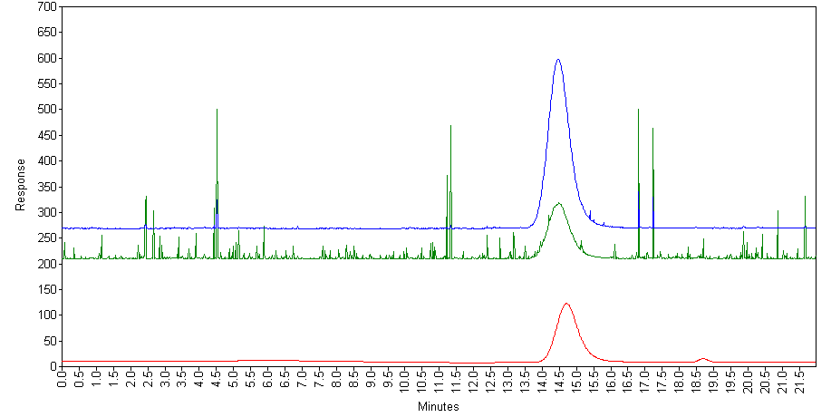

Our data is collected in real time. 1 to 10 points per second for a total time of up to 1 hour.
I've attached an image to show you some typical data. Each series may have 2000 - 60000 data points.
If I use DrawAllPoints=false then some of those spikes on the green series will disappear as some of the spikes are only 3 or 4 data points wide. I can't down sample as this data is collected in real time with the graph updated with new data points every second. Also, the user will want to zoom in on the detail in the graph. Obviously, if I down sample, then the detail will be lost.
Another problem is that as the data is collected, spikes will appear and disappear depending upon which data point is used for drawing. This is very disconcerting for the user as their data will appear to change. Again, if the user rescales the graph window the data will appear to change.
If this is not clear, then I'll create an example in code for you.
The reason I still think it's a bug is that I feel that the graph should accurately represent the data at all times. The current implementation of DrawAllPoints=false clearly does not do this. However, if you change your drawing algorithm to the way it worked in the old TeeChart and plot the min and max values at each pixel then it will accurately represent the data.
Best regards
