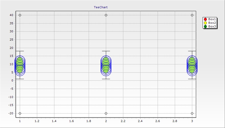

I have made changes in last code I send you, and I think works correctly and you could use a similar code as next:
        bool[] Selected1;
        bool[] Selected2;
        bool[] Selected3;
      //  Steema.TeeChart.Styles.Line line;
        bool drawrectangle;
        Steema.TeeChart.Styles.Box box1,box2,box3;
        Rectangle rect;
            //------------------INITIALIZE CHART WITH LINE--------------------------//
            //line = new Steema.TeeChart.Styles.Line(tChart1.Chart);
            //line.FillSampleValues();
            //line.Pointer.Visible = true;
            //-----------------INITIALIZE CHART WITH BOXPLOT-----------------------//
            box1 = new Steema.TeeChart.Styles.Box(tChart1.Chart);
            box2 = new Steema.TeeChart.Styles.Box(tChart1.Chart);
            box3 = new Steema.TeeChart.Styles.Box(tChart1.Chart);
            tChart1.Aspect.ClipPoints = true;
            drawrectangle = false;
            box1.FillSampleValues();
            box2.FillSampleValues();
            box3.FillSampleValues();
            box1.Position = 1;
            box2.Position = 2;
            box3.Position = 3;
            box1.Color = Color.Red;
            box2.Color = Color.Yellow;
            box3.Color = Color.Green;
            box1.Title = "Box1";
            box2.Title = "Box2";
            box3.Title = "Box3";
            box1.Pointer.Visible = true;
            box2.Pointer.Visible = true;
            box3.Pointer.Visible = true;
            Selected1 =  new bool[box1.Count];
            Selected2 = new bool[box2.Count];
            Selected3 = new bool[box3.Count];
            tChart1.Panning.MouseButton = MouseButtons.Middle;
            tChart1.MouseMove += new MouseEventHandler(tChart1_MouseMove);
            tChart1.MouseUp += new MouseEventHandler(tChart1_MouseUp);
            tChart1.MouseDown += new MouseEventHandler(tChart1_MouseDown);
            box1.GetPointerStyle += new Steema.TeeChart.Styles.CustomPoint.GetPointerStyleEventHandler(box1_GetPointerStyle);
            box2.GetPointerStyle += new Steema.TeeChart.Styles.CustomPoint.GetPointerStyleEventHandler(box2_GetPointerStyle);
            box3.GetPointerStyle += new Steema.TeeChart.Styles.CustomPoint.GetPointerStyleEventHandler(box3_GetPointerStyle);
            tChart1.Draw();
            ResetCoords();
            if ((X0 != -1) && (Y0 != -1))
                if (drawrectangle)
                    g.Brush.Visible = false;
                    g.Pen.Color = Color.Black;
                    g.Rectangle(X0, Y0, X1, Y1);
            for (int i = 0; i < Selected1.Length; i++)
                for (int j = 0; j < tChart1.Series.Count; j++)
                    Point p = new Point(tChart1[j].CalcXPos(i), tChart1[j].CalcYPos(i));
                    Rectangle rect1 = new Rectangle(p.X - box1.Pointer.HorizSize - 5, p.Y - box1.Pointer.VertSize - 5, (box1.Pointer.HorizSize + 5) * 2, (box1.Pointer.VertSize + 5) * 2);
                    switch(j)
                        case 0 :
                            if (Selected1[i])
                                g.Pen.Color = Color.Blue;
                                g.Ellipse(rect1);
                                box1.Pointer.Brush.Color = Color.Red;
                            break;
                        case 1 :
                            if (Selected2[i])
                                g.Ellipse(rect1);
                                box2.Pointer.Brush.Color = Color.Yellow;
                            break;
                      case 2 :
                          if (Selected3[i])
                              g.Ellipse(rect1);
                            box3.Pointer.Brush.Color = Color.Green;
                        break;
                if (Selected1[i] && Selected2[i] && Selected3[i])
                        g.Ellipse(rect1);
        void tChart1_MouseDown(object sender, MouseEventArgs e)
            if (e.Button == MouseButtons.Right)
                drawrectangle = true;
                X0 = e.X;
                Y0 = e.Y;
        void tChart1_MouseUp(object sender, MouseEventArgs e)
                rect = new Rectangle(X0, Y0, e.X - X0, e.Y - Y0);
                        if (j == 0)
                       // Point p1 = new Point((tChart1[j] as Steema.TeeChart.Styles.Box).CalcXPos((int)(tChart1[j] as Steema.TeeChart.Styles.Box).MildOut.Series[i].X), (tChart1[j] as Steema.TeeChart.Styles.Box).CalcYPos((int)(tChart1[j] as Steema.TeeChart.Styles.Box).MildOut.Series[i].Y));
                            if (rect.Contains(p))
                                Selected1[i]=true;
                                Selected1[i]=false;
                        else if (j == 1)
                                Selected2[i] = true;
                                Selected2[i] =false;
                        else if (j == 2)
                               Selected3[i] = true;
                               Selected3[i] = false;
                ResetCoords();
            tChart1.Draw();
        private int X0, Y0, X1, Y1;
        void tChart1_MouseMove(object sender, MouseEventArgs e)
                X1 = e.X;
                Y1 = e.Y;
            tChart1.Invalidate();
        // Add GetPointerStyle for 3 box plots.
        void box1_GetPointerStyle(Steema.TeeChart.Styles.CustomPoint series, Steema.TeeChart.Styles.GetPointerStyleEventArgs e)
            e.Style = Steema.TeeChart.Styles.PointerStyles.Circle;
                if (Selected1[i])
                    series.Pointer.Brush.Color = Color.GreenYellow;
        void box3_GetPointerStyle(Steema.TeeChart.Styles.CustomPoint series, Steema.TeeChart.Styles.GetPointerStyleEventArgs e)
            for (int i = 0; i < Selected3.Length; i++)
                if (Selected3[i])
    // Add Get PointerStyle for 3 box plots.
        void box2_GetPointerStyle(Steema.TeeChart.Styles.CustomPoint series, Steema.TeeChart.Styles.GetPointerStyleEventArgs e)
            for (int i = 0; i < Selected2.Length; i++)
                if (Selected2[i])
        private void ResetCoords()
            X0 = -1;
            Y0 = -1;

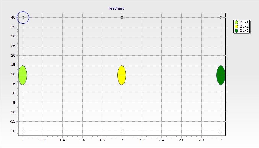

Please check previously code works fine. For check that works you have do next:
For select points:
Click with button Right and draw rectangle of size that you want and containing points.
For unselect:
Click with button Right in the canvas of your Chart.

1) Only the points at the Q1 of each box is getting selected and not all the points of the box.
I couldn't reproduce your issue, please see next image:
Unable to select the circular point of 1st box (which is in the rectangular box ) and change its color .
I couldn't reproduce your this problem:

Here the Color of the box is getting changing when selected instead of changing the color of the point using which box plot is plotted.
I could reproduce your problem, and now, isn't possible paint only MidleOut of BoxPlot series, I have added your suggestion in Feauter Request with number[TF02014359] to regards in features versions of TeeChartFor .Net.

Instead of marking with circle, Is it possible to change the color of those points which is represent outside of the boxplot.
With regards,
Vivek.J
Re: Need help in BoxPlot
Posted: Tue Aug 25, 2009 9:35 am
by 10050769
Hello vivek,
I have to communicate that I check the project using version 3 and I could reproduce your problems. I think the problem is when calculate the X position. I have added this in the list of Bug Report with number [TF02014361]. We will try to fix it for next versions of TeeChart .NET.
You, could change the color of outside points of BoxPlot(MiddleOut or ExtrOut), but as I said in last post, There is a Feauter Request with number[TF02014359] that explain that when selected the point outside plot is not possible change the color only this when is selected. But If you want change the color for Outside boxplot, because there aren't transparents please see next lines of code:
            box1.MildOut.Transparency = 0;
            box2.MildOut.Transparency = 0;
            box3.MildOut.Transparency = 0;
            box1.MildOut.Brush.Color = Color.GreenYellow;
            box2.MildOut.Brush.Color = Color.GreenYellow;
            box3.MildOut.Brush.Color = Color.GreenYellow;
