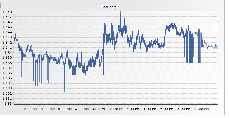

I have 250,000 datapoints in my graph for time against bid price , the plot for bid price can be as high as 10 times a second , see the attached graph for sample data for a day with 2.5Lakh datapoints.
