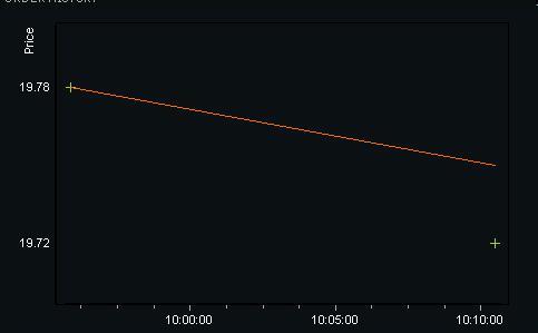

Can I move the axes title to a custom position. By default it stays in the center I want to move it upwards.
I added foll. code to do this
void Chart_AfterDraw(object sender, Steema.TeeChart.Drawing.Graphics3D g)
Rectangle Rect = chart.Chart.Chart.ChartRect;
g.RotateLabel(Rect.Left - customLeftAxis.MaxLabelsWidth() - 30, Rect.Top + 30, customLeftAxis.Title.Text, 90);
But I am not able to change the color of the label. Is there any way to do that. I tried setting font color but still did not work

Post by gs » Thu Jul 30, 2009 1:33 pm
Hi Narcis,
I was talking about the title on the axes and not axes label.
Using the code below I am able to move the axis title to custom position but am not able to change color. The color remains the same as that of axis label.
Sachin

Ok, in that case you need to sent chart's canvas font color, for example:
			g.Font.Color = Color.Red;

Post by gs » Thu Jul 30, 2009 2:44 pm
I am attaching the picture
Here are my code changes. Still the price title remains white. It takes the color of the axis label.
